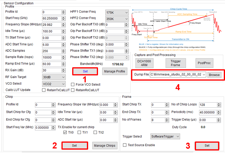

  • Hello Surya,
    So it seems that you are no longer getting the "MSS Power Up async event was not received!" parameter is that correct? You are able to power up, and get DCA1000's FPGA information, but when you go to start the sensor via DCA1000 ARM and Trigger Frame the .bin is empty correct?
    What this means is that similar to when you run our example projects, when a profile/chirp configuration is invalid due to one or more parameters, the front end is unable to start. Have you verified that the settings you are putting for mmWaveStudio's Sensor Configuration tab is at least valid when inputted into the mmWaveSensingEstimator? Try using a default configuration to try to get it working at least once. The settings seen in the above screenshot should work as far as I am aware.

  • Hello Pedrhom,
      Thank you for your reply. Yes I went past the SPI connectivity issue (apologies for the title of this post) but yes the issue is with getting the data. I do not see the .bin file at all. Start Frame fails with that error I mentioned. I am following this (https://dev.ti.com/tirex/explore/node?a=VLyFKFf__4.12.1&node=A__AGTrhNYW8jE6cMxbovlfaA__com.ti.mmwave_industrial_toolbox__VLyFKFf__4.12.1) from one of your responses on E2E and used the exact values.
    I am using 3D people tracking firmware. Hope that is not an issue. I am trying just the default config for now (the ones from the above link).
    Here's a snapshot of the sensorConfig tab (the only difference I notice in my case is that under Frame "Active-Ramp Duty Cycle" is 19.2% and "Duty Cycle" is 51.2% whereas the guide shows "Duty Cycle" as 0%)
