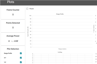

I am having issues getting any of the demos to work - I walk through the instructions to use the SDK visualizer tool, successfully flash the board, and when I try to upload a configuration and one of two things happens:
1.   I am getting an error message saying "Error halting device"
OR

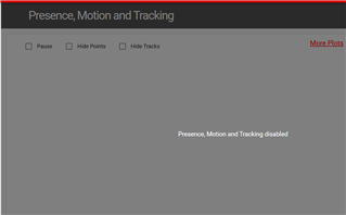

2.   The configuration loads, and I get a plot on screen, but it is frozen.   I try to "restart evaluation", enable/disable data logging and nothing works.   Everything is frozen, tracking is disabled.
My understanding is that once I upload a configuration, I should be seeing live data.   I have tried the industrial visualizer in radar toolbox as well, and I am not seeing anything happen.   I suspect I am doing something wrong, but need some advice

    Nothing is happening - I see in the CLI terminal it is not seeing any data from the device
    I am using the config below
    C:/ti/radar_toolbox_3_10_00_05/source/ti/examples/Industrial_and_Personal_Electronics/Bike_Radar/profiles/profile_120m_40mpsec_bsdevm_16tracks.cfg
    I have tried every SOP configuration I can think of (but mainly the one shown below), and I can't get this thing to work.   Depending on when I run it, I get two issues shown below in the CLI terminal:

    Config screen

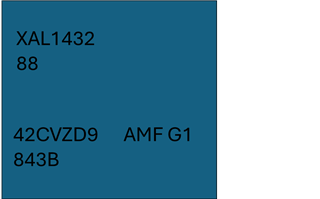

    Are you using an ES2 silicon  ? Can you send the device image so that we'll look at the markings?
    Also, for the switch settings, please try out this way.
    1. Flashing mode - All the switches are down.
    2. Functional mode - S1.1 only up.
    If it doesn't work with this settings and the binary, then possibly you are using an ES1 silicon. We can check once you share the device image.
  • The 1432 chip markings are shown here:
