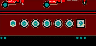

  2. Also, can you help me identify which is pin number 1 on the J2 connector of SPI A Header of eval board, is it the left most pin or the right most one?
  3. Below is the configuration of MCSPI0. Can you please verify this configuration.
  • Hi Mitraj,
    To use the SPIA header, turning On S4.3 should be sufficient. While using the SPIA header with external device, are you connecting VCC3V3 and gnd too?
    The leftmost pin is gnd and the right one is 3V3. Rest of the signals are in sequential order as per the schematic.

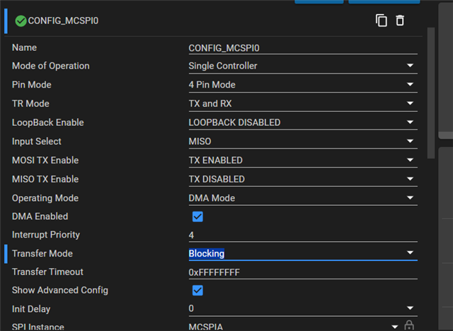

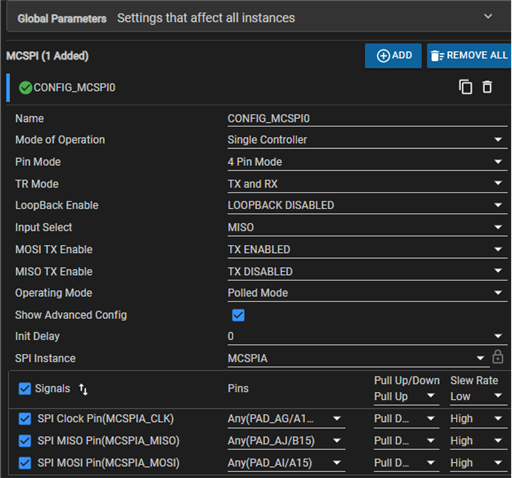

  • Hello Kristen, here is the channel configuration
  • Hey Mitraj,
    Your settings appear to be fine. Are you also properly formatting the SPI pWriteData buffer to be compliant with OA-SPI transactions? I would hook up a logic analyzer to the MOSI and MISO lines between the AWRL6844 and AD3306 and verify data is being sent out or not. If your sending control command transactions, you should get responses on the MISO line if the SPI transaction is formatted correctly.

    The issue is resolved once I build it in Debug mode and it was sending out data and also receiving it back. But when in Release mode i see there is no data being updated in the tx buffer for the same software which is the reason it was stuck at MCSPI_Transfer. Do you know why this is happening?
  • Hello Kristien,
    The spi works fine in polling mode but not in DMA mode. Can you tell me the configuration for DMA mode
