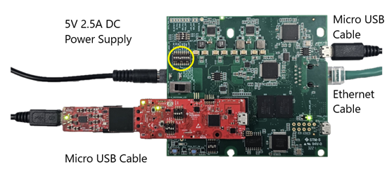

I was following "DCA1000 mmWave Studio User Guide" to configure my DCA1000EVM and IWR6843AOPEVM revG. When I got to step 5 "Connecting to DCA1000", after clicked "Connect, Reset and Configure" botton, unable to read FPGA version error poped up in Output window.
# Host PC configuration
OS version: Windows11 24H2
The IP of the network card connecting to DCA1000EVM shown in the pic below.
Fire wall, wifi and antivirus sofware are turned off.
# DCA1000EVM configuration
Dip switchs:
SW1[3:1]:off on on
SW2[8:1]:off off on on off off on off
SW3:DC_JACK_5V_IN
S1[4:1]:on off on off
# Wiring:
DCA1000EVM:
J1 connected to host PC via usb cable, J2 connected to lab power supply (output set at 5v 3A) via home-made cable, J6 connected to host PC via network cable come within the package.
IWR6843AOPEVM:
J1 connected to host PC via usb cable, J11 connected to DCA1000EVM directly.
When powered up, 5v led on DCA1000EVM lighted up and stay on, FPGA_INITN led flashed one time, and DATA_TRAN_PRG led to EEPROM_RD_FAIL led light up dim. After 6 seconds, DATA_TRAN_PRG led to EEPROM_RD_FAIL led turned off and FPGA_DONE_LED lighted up and stay on. After taht, the orange led on J6 lighted up and stay on,the green led flashed few times, and turned off.
The current stared from 0.41A then jumped to 0.46A, then stayed at 0.55A.
After the first time having this issue, I reflash the FPGA with DCA1000_FPGA_RECORD_V2.8_05JUL2019.bit file, but didn't solved this problem.
I also manuallay added arp record by running command netsh -c "i i" add neighbors [Idx] "192.168.33.180" "12-34-56-78-90-12", I can see the green led on J6 flashed once every time when mmWave studio sent out command to DCA1000EVM, but this also didn't solved this problem.

What should I do to solve this connection problem?
