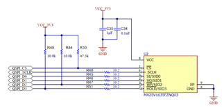

    I’m using the QSPI module to communicate with the flash memory. Since I also need to send commands like JEDEC ID reads and other flash register reads (not just standard read/write operations), I’m using Config Port mode instead of the memory-mapped protocol translator.
    I'm working with the AWRL6844EVM board and the MX25V1635FZNQ03 flash. However, I don’t believe the issue is related to the flash itself, as it seems to respond with the correct data.
    The problem is that I can’t observe the response data in the SPI_DATAx registers.

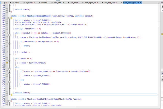

    Additionally, we have an example in the SDK which has a QSPI flash transfer example. I understand that you do not want to use the memory-mapped protocol translator because you still want to be able to send commands. You can use it in memory mapped protocol and still send commands. You can find the example here: [MMWAVE_L_SDK_06_00_05]\mmwave_l_sdk_06_00_05_01\examples\drivers\qspi\qspi_flash_transfer\qspi_flash_transfer.c
    Vignesh K.

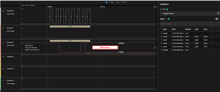

    Regarding the point first point, I'm unable to read the JEDEC ID. With a logic analyzer attached to the QSPI lines, I can see that the flash responds with the correct ID. However, the value does not appear in the DATA registers of QSPI module.
    Jaka

  • Hi Vignesh,
    After sending JEDEC ID command and trying to read 3 bytes response, the SPI_STATUS has value 0x00040006, meaning that word complete bit set, Frame complete bit set and word count 4. The BUSY bit is 0 which means that the transfer is not in progress. I really don't know what else could be the reason for that behaviour.
    Jaka

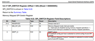

  • I'm not sure if this is related to the issue I'm describing, but I can't set the WLEN field of the SPI_CMD register to a value higher than 0x1F.
    According to the TRM, 0x7F (127) should be used to select a 128-bit word length (meaning all four 32-bit data registers), but this configuration doesn't seem to work.
    Is there any known issue with the QSPI controller?
    I've also tried connecting and loading the QSPI example from the SDK using Code Composer Studio, but I’m unable to connect to the controller. The following error is reported:
    Error connecting to the target: (Error -2062 @ 0x0)
    Interestingly, Uniflash does manage to connect to the core, so I believe the jumpers and DIP switches are correctly configured.
    At this point, I'm not sure what else to try. Any useful suggestions would be appreciated.

  • Hi Vignesh,
    I tried a few examples from the CSS, and the symptoms are similar to what I described before. I tested
    • qspi_flash_dma_transfer_xwrL684x-evm_r5fss0-0_nortos_ti-arm-clang
    • qspi_flash_transfer_xwrL684x-evm_r5fss0-0_nortos_ti-arm-clang
    with both the default configuration and with the library manually configured via the SYSCONFIG tool to use SPI instead of QSPI.
    In all of these workspaces, the response from the flash chip is visible on the data lines but not in the SPI_DATA register—the same behavior I described when using my own functions.
    For example, the Flash_norQspiWaitReady() function times out because it reads an invalid response from the external flash.
    There must be something wrong with the QSPI module. The MX25V1635F chip works fine in my opinion.
    I really don't know what else could be the problem here.
    Jaka

  • Hi Vignesh,
    I've been working on the QSPI issue and wanted to clarify a few points based on our last exchange.
    I am not using the SPI module instead of the QSPI module. The screenshot I attached last time shows that I'm using qspi_flash_transfer() from the \mmwave_l_sdk_06_00_05_01\examples\drivers\qspi\qspi_flash_transfer\xwrL684x-evm\r5fss0-0_freertos folder, so the SDK should be using the correct module.
    Regarding your last point, I'm using the example as is, without any modifications. I've tried the following examples:
    both have the same issue.
    Just to be clear, when I mentioned the different configurations, I meant that I've configured the QSPI module to use either 1S-1S-4S or 1S-1S-1S for transmitting, and the behavior is the same in both cases. Not that I am using SPI for QSPI pins.
    I hope this clarifies things.
    Jaka
