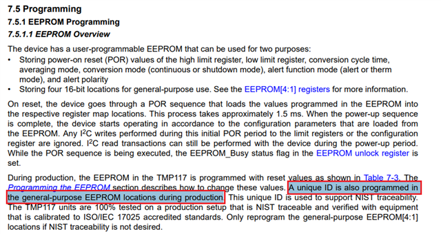

Dear TI Engineer,
I have some question about the unique ID which programmed in the general-purpose EEPROM locations during production. Does this unique ID built-in by TMP117 itself or does it need to be written through I2C? Can you help confirm it?
