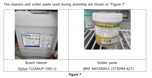

    Thank you for the detailed report, it is tremendously helpful. From reviewing your files, I see no issue with your storage, testing setup, PCB design, humidity reference, or reflow profile. The only thing that stands out to me is your solder paste and cleaner:
    We recommend not using any board cleaners, and using only no-clean solder paste. I am having a hard time finding more details on these materials, but right now I suspect that these are the root cause of the RH errors you are seeing. Could you please provide the material safety datasheets (MSDS) of these two items, so that we may review them for potential sources of chemical contamination? Did you test any that did not use these materials?

    We have attached the MSDS for the solder paste and cleaner used in each group for the reference.

    As shown in the table, both hand soldering and SMT assembly methods were used. Group 2 and Group 3-2 share the same assembly process and materials (solder paste and cleaner). During the cleaning process, the sensing area was carefully protected using Kapton tape to prevent any contamination, and only non-critical areas were cleaned.
    Despite these precautions, all sensors within the groups exhibited a positive offset in measurements, with Group 2 showing the most significant deviation. Based on this, we believe that the use of cleaner and the cleaning process itself are unlikely to be the direct cause of the measurement deviation.
    Although we attempted to apply a software correction based on the measured data, the existing positive offset and increasing trend in error make it difficult to compensate for saturation errors occurring above 95%RH.
