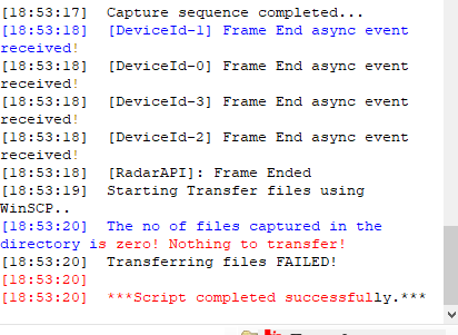

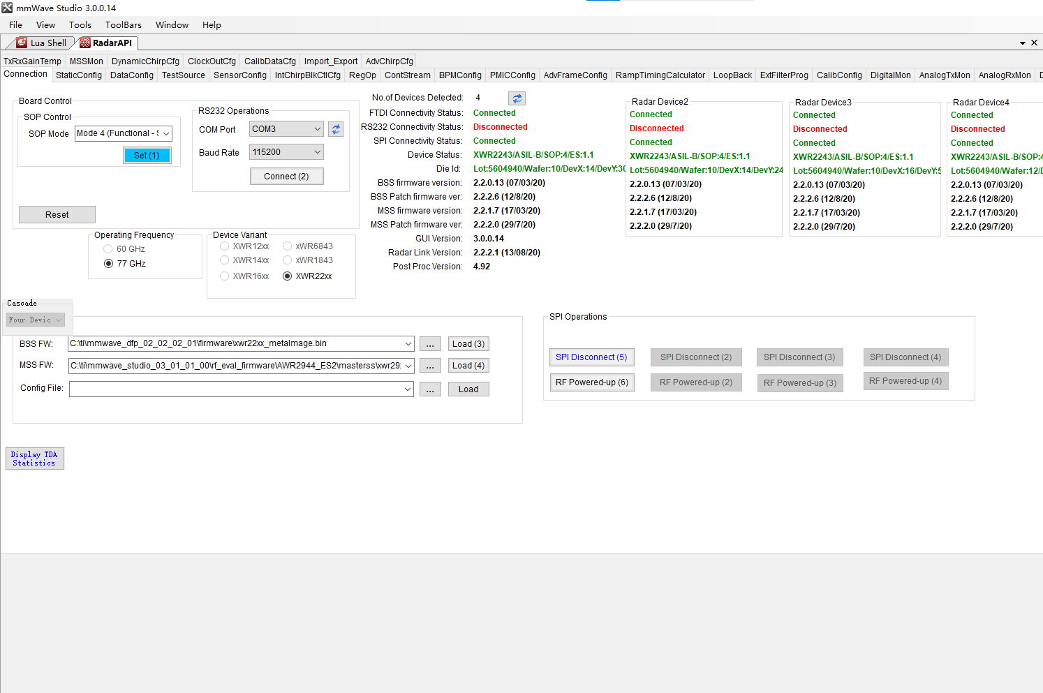

Dear TI experts,
we encountered an issue while using MMwave Studio and the 2243 cascaded EVM+TDA2 evm to collect data. The boards were able to collect data normally before, but now during the data collection process, it keeps showing that the number of data files is zero.Refer this  post ,we have restarted and powered off many times but still haven't been able to solve the problem. This is our log information. There were no errors reported during the connection and configuration process. Please help us check the problem and we look forward to your reply.

[18:35:54]  Loops Remaining : 1
[18:35:54]  Starting TDA ARM...
[18:35:54]  [RadarAPI]: ar1.TDACaptureCard_StartRecord_mult(1, 0, 0, Cascade_Capture_22xx, 10)
[18:35:54]  Device 0 - Configuring TDA with Width : 2048 and Height : 768
[18:35:54]  [RadarAPI]: Device 0 - setWidthAndHeight Status: Passed
[18:35:54]  [RadarAPI]: Device 1 : CAPTURE_RESPONSE_ACK Async event recieved() with status 0
[18:35:54]  Device 1 - Configuring TDA with Width : 2048 and Height : 768
[18:35:54]  [RadarAPI]: Device 1 - setWidthAndHeight Status: Passed
[18:35:54]  [RadarAPI]: Device 2 : CAPTURE_RESPONSE_ACK Async event recieved() with status 0
[18:35:54]  Device 2 - Configuring TDA with Width : 2048 and Height : 768
[18:35:54]  [RadarAPI]: Device 2 - setWidthAndHeight Status: Passed
[18:35:54]  [RadarAPI]: Device 4 : CAPTURE_RESPONSE_ACK Async event recieved() with status 0
[18:35:54]  Device 3 - Configuring TDA with Width : 2048 and Height : 768
[18:35:54]  [RadarAPI]: Device 3 - setWidthAndHeight Status: Passed
[18:35:54]  [RadarAPI]: Device 8 : CAPTURE_RESPONSE_ACK Async event recieved() with status 0
[18:35:54]  Sending Frame Periodicity of 100 to TDA..
[18:35:54]  [RadarAPI]: Status: Passed. Frame Periodicity sent to TDA
[18:35:54]  [RadarAPI]: Device 32 : CAPTURE_RESPONSE_ACK Async event recieved() with status 0
[18:35:54]  Sending Capture Directory with name /mnt/ssd/Cascade_Capture_22xx to TDA..
[18:35:54]  [RadarAPI]: Status: Passed. Capture Directory sent to TDA
[18:35:54]  Sending File Allocation of 0 files to TDA..
[18:35:54]  [RadarAPI]: Status: Passed. File Allocation sent to TDA
[18:35:54]  Sending Enable Data Packaging (0 - 16-bit; 1 - 12-bit) with value of 0 to TDA..
[18:35:54]  [RadarAPI]: Status: Passed. Enable Data Packaging sent to TDA
[18:35:54]  Sending Number of frames to capture with value of 10 to TDA..
[18:35:54]  [RadarAPI]: Status: Passed. Number of frames to capture sent to TDA
[18:35:54]  [RadarAPI]: Status: Passed for notifying TDA about Creating Application
[18:35:55]  [RadarAPI]: Status: Passed for notifying TDA about Start Frame
[18:35:55]  [RadarAPI]: Device 32 : CAPTURE_RESPONSE_ACK Async event recieved() with status 0
[18:35:55]  TDA ARM Successful
[18:35:56]  Starting Frame Trigger sequence...
[18:35:56]  [RadarAPI]: ar1.StartFrame_mult(8)
[18:35:56]  [RadarAPI]: Status: Passed
[18:35:56]  Device 4 : Start Frame Successful
[18:35:56]  [RadarAPI]: ar1.StartFrame_mult(4)
[18:35:56]  [DeviceId-3] Frame start async event received!
[18:35:56]  Status: Passed for notifying TDA about Stop Frame
[18:35:56]  [RadarAPI]: Device 32 : CAPTURE_RESPONSE_ACK Async event recieved() with status 0
[18:35:56]  Device 3 : Start Frame Successful
[18:35:56]  [RadarAPI]: ar1.StartFrame_mult(2)
[18:35:56]  [DeviceId-2] Frame start async event received!
[18:35:56]  Device 2 : Start Frame Successful
[18:35:56]  [RadarAPI]: ar1.StartFrame_mult(1)
[18:35:56]  [DeviceId-1] Frame start async event received!
[18:35:56]  Device 1 : Start Frame Successful
[18:35:56]  Capturing AWR device data to the TDA SSD...
[18:35:56]  [DeviceId-0] Frame start async event received!
[18:35:58]  Capture sequence completed...
[18:35:59]  [RadarAPI]: Frame Ended
[18:35:59]  [DeviceId-3] Frame End async event received!
[18:35:59]  [DeviceId-0] Frame End async event received!
[18:35:59]  [DeviceId-2] Frame End async event received!
[18:35:59]  [DeviceId-1] Frame End async event received!
[18:36:00]  Starting Transfer files using WinSCP..
[18:36:01]  The no of files captured in the directory is zero! Nothing to transfer!
[18:36:02]  Transferring files FAILED!

    This seems to be an issue with the transfer process.
    Could you try a different Ethernet cable and PC?
    If this still does not work there may be an issue with the Digital board (the green board)
    Thank you
