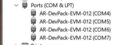

    It looks like you are connecting your micro-usb cable to FTDI_USB port. Please disconnect from there and connect to XDS_USB port. You should then see corresponding UART and data ports.
    Gabriel
  • Hi Gabriel
    I connect them both  FTDI_USB port , XDS_USB port - The problem was the power supply , because it sis not supply power there was no recognize the ports
    *** Now it show the data port and application port , but there are still 4 unknown ports  ( com 4-7) that are not recognize
    if i disconnect the Usb they disappear with the application and the data port
    But still there is the a problem , it is not possible to  flash - please  my next question below
