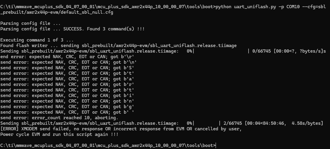

I am trying to flash  .cfg  without success but in previous time it did flash without any problem
python uart_uniflash.py -p COM<x> --cfg=sbl_prebuilt/awr2x44p-evm/default_sbl_null.cfg

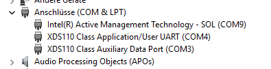

  • I have the same problem, but this hardware has never worked for me. I am currently working with an older version of the hardware, where flashing the SBL was not a problem. To be precise, it does not work with version AWR2E44PEVM, but it does work with version AWR2E44 LOP EVM.

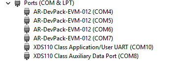

    First please make sure to only connect to XDS_USB port. Not the FTDI port.
    Second, make sure you have a 12V and approx 2.5A power supply.

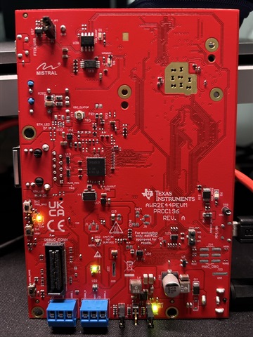

    To continue can you please send a picture of your setup? I want to verify the SOP switches are in a correct mode.

  • Hello Gabriel,
    Thanks for your quick reply. Here are the pictures you requested...
    Andreas

    I don't understand what you mean by "Suddenly not working." Can you give a better explanation on what happened. Did you unplug something? What were you able to flash before? Have you tried just flashing the OOB demo?

  • Hi
    this doc shows all the step that i did ' the command of flash using python still does not allow to flash , after writing the command it show the following respond
    I managed to flash the same exact .cfg that was giving you issues so I will provide my exact steps to help you reproduce
    Note* Ensure to power cycle the board before every flash attempt.
    1) Run setenv.bat, make sure that MMWAVE_SDK_DEVICE is set to awr2x44p
    2) Next in terminal navigate to the following path in the SDK. From there edit the .cfg file to fix the file paths. I have also just attacked the one I used if that is easier
    C:\ti\mmwave_mcuplus_sdk_04_07_01_03\mcu_plus_sdk_awr2x44p_10_01_00_04\tools\boot\sbl_prebuilt\awr2x44p-evm\
    3) Next run the python command
    python C:\ti\mmwave_mcuplus_sdk_04_07_01_03\mcu_plus_sdk_awr2x44p_10_01_00_04\tools\boot\uart_uniflash.py -p COM33 --cfg=default_sbl_null.cfg
    The flashing should be successful. Again make sure to restart the board (by unplugging its power source) and then try to flash.

  • I figured out what the problem was, now I can work on it. The crypto part is active on my chip and I can only write signed images to the flash memory. The sample images provided in the SDK are not signed and are therefore rejected by the bootloader.
