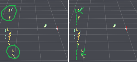

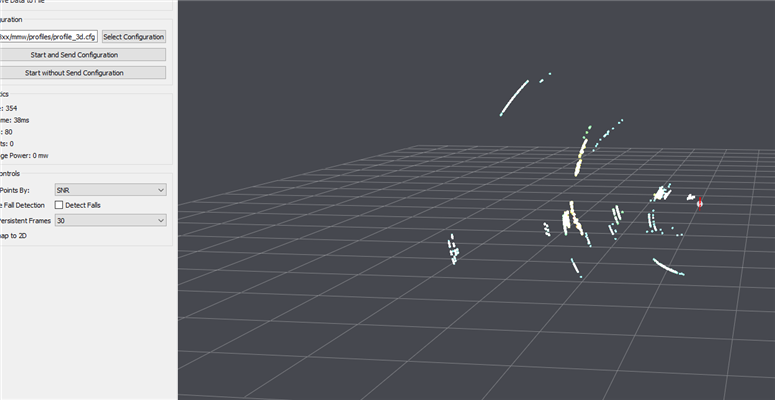

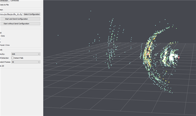

Point cloud output seems like spherical as seen in the pictures even though OOB demo outputs point cloud as x, y, z coordinates.
This spherical point cloud is also observed on MRR demo.
Previously, we used IWRL6432 whose point cloud output were not like this spherical form but more like cartesian.
1) Can you explain this form? Is it about AWR1843 or OOB demo?
*We are using AWR1843BOOST with profile_3d.cfg & profile_2d.cfg configurations.
2) Is it possible to get correct <x, y, z> coordinates of objects with OOB demo?
Because, the distance between radar and wall is not same for all elevation angles.
(eg. at 0° d=3.0m, at 30° d=3.2m)

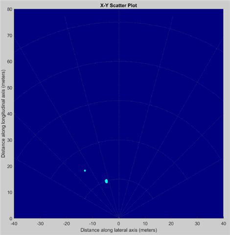

Also, we were testing MRR demo and realized problem in USRR subframe point cloud output as explained below post.
In short, as the target goes farther away (in straight line) from radar, its azimuth angle is increasing towards -y axes.
3) We could not find any solution in forum, assuming there is no solution to this error on MRR demo?

    • In USRR/MRR mode only MRR subframe has correct output
    • USRR mode not working
    • MRR mode not working
    Unfortunately USRR mode not supported.
    Regarding the OOB demo
    We have used this demo many times with the provided GUI or internal Matlab GUI. We have never seen similar issues.
    So, I think that there may be an issue with your GUI
