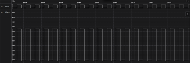

    The frameCfg->triggerSelect from 1 (SW trigger) to 2 (hardware trigger) is correct change. With this it should work for you. How are you providing the pulse on the Sync in pin?
    Can you probe the pin and provide a snap shot of the pulse train on the pin? Also what is frame periodicity you are using?
    Can you confirm if the sensor transmits anything or not when you provide the pulse? Also do refer to the Interface control document to verify if you meet the pulse requirements or not.
    Pradipta.
    The frame trigger signal I have is 20Hz, 50% duty cycle. Looks like it doesn't satisfy pulse width requirement (less than 4us pulse width).
    Let me change the trigger signal and let you know if it works or not.
    Quoc
