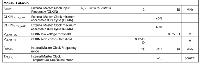

    Additionally, we would like to omit the external crystal oscillator to reduce costs. However, I have some doubts regarding the internal clock of the LDC1612. The Clock Temperature Coefficient mean is quite low, but the range of fINTCLK is 35MHz to 55MHz, with a typical value of 43.4MHz. Is this due to chip manufacturing variations, meaning that the internal clock frequency of most chips is around 43.4MHz, while a small portion of chips have internal clock frequencies closer to 35MHz or 55MHz?
  • See the thread below which addresses this.  Your understanding is correct though.  Typical value is 43.4MHz, but there will be a portion of devices that can be higher or lower.
