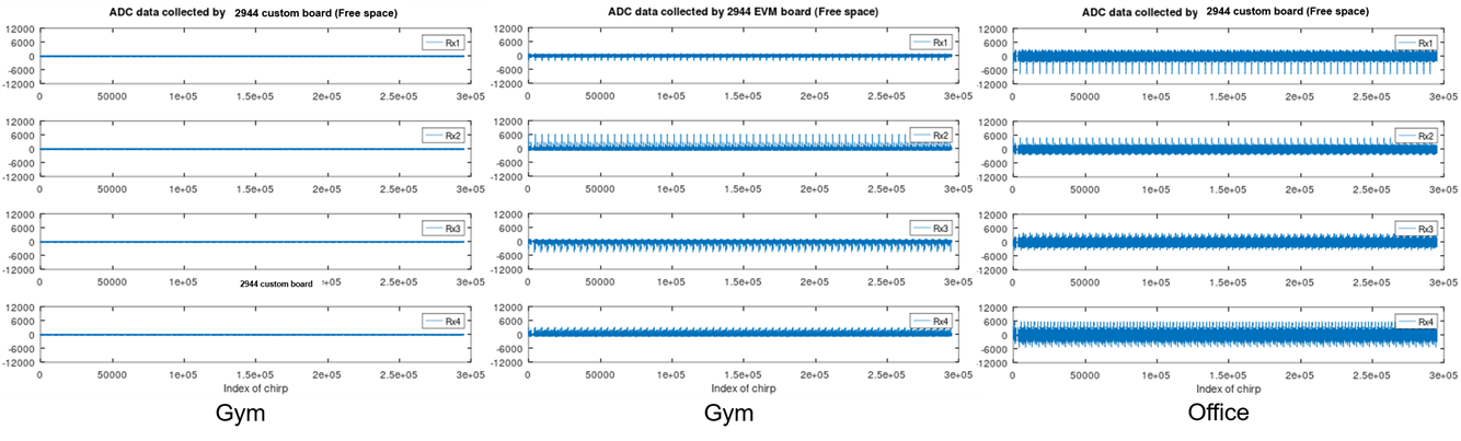

I used the DCA1000 together with the custom board and EVM board and collected ADC data with mmw_Demo_DDM, without placing a CR in front of the radar.
We found that in the gym environment (a relatively clean indoor environment with fewer objects), when using the custom board, the ADC data amplitude was very small, about +/-200, whereas with the EVM board, the ADC data amplitude was about +/-4000.

In this experiment, the amplitude was around +/-5000 in the office.

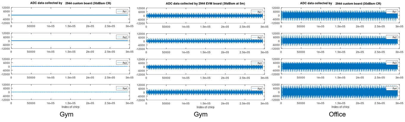

Next, I placed a static target (30 dBsm CR) in front of the radar at 5 m.
The amplitude of the ADC data received by the custom board was unexpectedly small (about +/-200), even with the 30 dBsm CR present in gym.

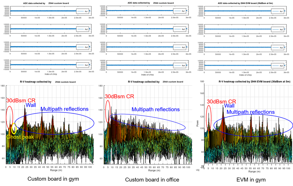

However, in the office, the amplitude of the ADC data received by the custom board matched expectations and became significantly larger compared to the free space case.

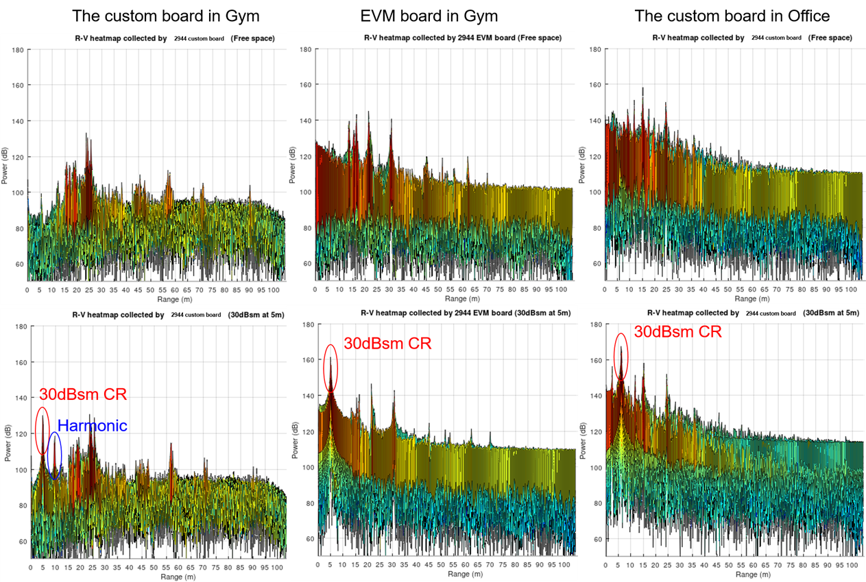

I further processed the collected ADC data using 2D-FFT in MATLAB and observed the R-V heatmap, focusing on the range domain at zero velocity.
Focusing on the first 10 m (since beyond 10 m multipath reflections appear in indoor space), when comparing the free space case with the 30 dBsm CR case:
  • With the custom board in the gym, a 30 dBsm CR appears at 5 m, but a harmonic appears at 10 m with lower ADC amp..
  • With the EVM board in the gym, a 30 dBsm CR appears at 5 m, but no harmonic appears at 10 m with higher ADC amp..
  • With the custom board in theoffice, a 30 dBsm CR appears at 5 m, but no harmonic appears at 10 m with higher ADC amp..
This makes me very curious why, with the custom board and a 30 dBsm CR in the gym, the ADC amplitude is very small and harmonics appear, while with the EVM board under the same condition, the ADC amplitude is larger and no harmonics are observed.

    I want to know if you kept the configuration same in both the scenarios and both the hardware setups. Also, could it be that the power supply setup was different in the gym than the office?
    Shailesh
  • Hi Shailesh,
    Yes, all the configurations are the same.
    I measured again, and this time the results are more reasonable. Below are the detailed test results.
    Test object and distance: 30 dBsm CR at 5 m
    Based on the above results, the ADC amplitudes are about the same.
    Could this be caused by errors in the environment setup?
    Also, I’m curious about my first question from last time.
    "Does the 2944 itself have a self-calibration mechanism? (e.g., automatically adjusting TX gain or TX power)"
    JiaQuan Zhao
  • Hi JiaQuan Zhao,
    AWR2944 has self-calibration mechanisms which will trigger at the time of booting the device and then also continues to calibrate periodically as per calibration configurations.
    But the calibrations depend only on the sensors inside the die, which means if the amplitude issue was due to environment or setup issues then the calibrations will not be able to sense and recover from it.
