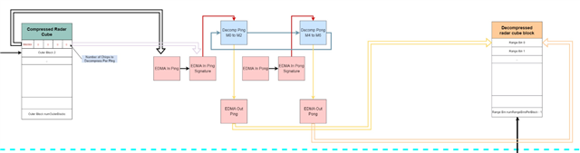

I am working with the AWR2944EVM OOB and HECR demos, and my goal is to extract from the raw radar cube a slice of post-range FFT data at a given range bin, across all chirps and all antennas. I have described the overall idea in more depth here: AWR2944EVM: Acces and compression of radar cube data
Since the DDMA demos use compression, I currently copy the data from the decomposition scratch buffer in dopplerprochwaDDMA.c. However, I suspect that I may be reading the wrong data, and I am not sure why, so I am reviewing the key assumptions and workings of the code.

I.) What is the actual layout inside the scratch buffer?
a.) Does the layout change depending on the compression method used (EGE vs BFP)?
b.) Or is the decompressed buffer always of the form: [numChirps][rangeBinsPerBlock (indexed via rangeBinIdx)][rxAntennas] regardless of the compressed memory layout?

  • Hi Mark,
    Format of Decompression scratch buffer wouldn't change based on the compression method used.
    Below is screenshot describing the format of decompressed scratch buffer from the same document that you are referring to -
