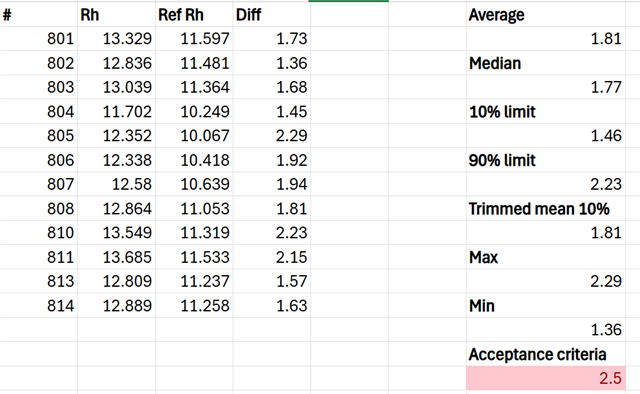

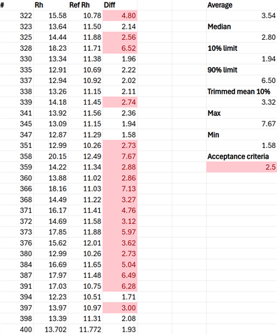

Below is an image of a chart where we tested 30 pcs of older selective soldered samples. We compared the humidity values reported by HDC3022DEJR to a calibrated humidity sensor. The # column are the sample IDs. The red cells indicate a sample which is 2.5 or more percentage units away from the reference value. As you can see, there's quite a lot that have considerable offset.
Below is an image from a newer hand soldered bach of samples. It's a smaller number of samples but it seems all of them report values closer to that of the reference sensor.
Do you think something like that could happen because of the change of the soldering process? Is there something else we could do to limit the chemical exposure during soldering?
  • Tuomas,
    Thanks for all this detailed information. After PCBA, the rehydration soak is performed (25C/50%RH/5 days) but no bake is required. In your case, a bake would likely lower the RH values, and likely wouldn't need to be repeated. If that works, you might be able to avoid assembly changes.
    The humidity sensor needs to be soldered at the last step of assembly, it cannot pass through additional reflow cycles (or any kind of wave soldering) due to the high temp exposure and additional chemical exposures. If the HDCs are mounted on the sensor boards while those glues are used to get the sensor board on the larger board, they could outgas and shift the RH up like you are seeing. The HDC does not need direct contact with these chemicals to create and RH shift, just the VOCs that the chemicals offgas can be enough to contaminate the parts.
    The hand soldering is more promising, because presumably the chemical exposures were removed in that process. It might be easier to try an additional bake step to clear out the RH offset you have instead of trying to track down all the potential error sources in the assembly process since there are so many.
