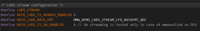

The HECR demo  doesn't use the CLI and is streaming data constantly during its operation. As such I was unable to gather data with the DCA1000EVM when I followed the same steps as I did with the OOB demo. Note: I did enable LVDS streaming in the chirp_design_HECR.h file.

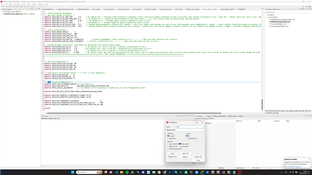

    How did you enable LVDSM streaming in the chirp_design_HECR.h file? Can you try as shown
    Also how are you rebuilding the HECR demo after you make the changes? I just want to make sure when you use setenv.bat to configure the build environment, that you are using the setenv.bat file from SDK 4.7.0.1 since that is what was used to build this demo.

    Yes I did connect enable LVDS streaming in the chirp_design_HECR.h files of the demo.

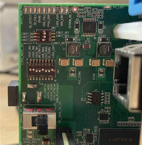

    • DCA100EVM:
      • Switches set as shown in photo

    Based on the log files it seems that despite the settings in the HECR file, no LVDS data are being streamed:
