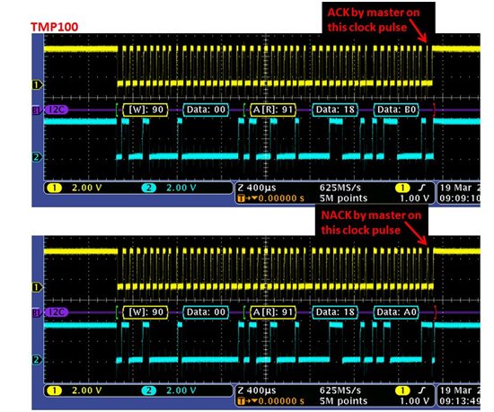

    Your specification for the device shows low level of output at 3mA. What is the maximum sink current?
    Timing diagrams for register read function show master-receiver ACK after last byte was read, then stop condition. However, the I2C bus specification states:
    "If a master-receiver is involved in a transfer, it must signal the end of data to the slave-transmitter by not generating an acknowledge on the last byte that was clocked out of the slave. The slave-transmitter must release the data line to allow the master to generate a STOP or repeated START condition."
    I'm following the I2C specification and NACK is generated after reading last byte. Please comment.
    Best regards
    Jacek
  • Jacek,
    The maximum sink current that we specify and assure in the datasheet is 3mA. I discussed this with the designer and the the device can easily sink 2x this current. This current is temperature and supply dependent so we suggest keeping the current to 3mA as this is what we can assure.
    I have tested the TMP100. Our device adheres to the I2C bus specification regarding the NACK from the master. As seen below the TMP100 will operate with either an ACK or NACK. I have also attached the PPT in order to view an image that is clear.
