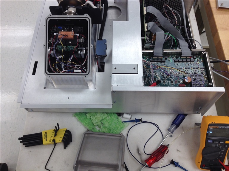

  • This is the bare board.  I am unable to photograph the board in question because it is enclosed in the copper isothermal reference junction.  I will send that picture in the next reply.
  • This is the picture of the reference junction board inside the copper isothermal block.  The brown-black-yellow harness carries the power and output to the front end board were this signal is amplified and digitized.
  • This picture shows the length of the run from the reference junction to the front end.  Notice the brown-black-yellow wire disappearing on the left side and terminating on the right side of the picture.

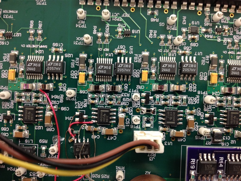

  • This picture shows the brown-black-yellow LM35 connections terminating on the front end board.

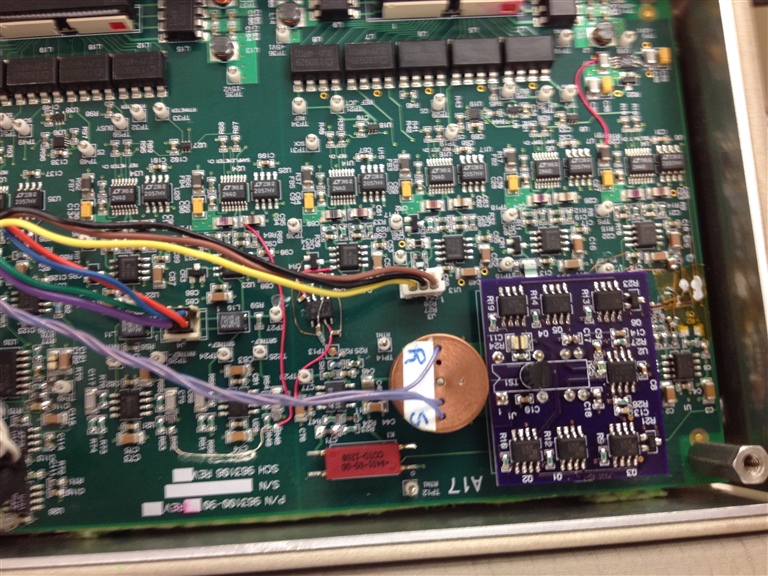

  • This last picture is a better picture showing the LM35 lines terminating on the front end board.  The yellow wire carries the output of the LM35.  Originally the signal was low pass filtered with  10KOhm-1uF.  In the course of troubleshooting I replaced the 10kOhm with a zero ohm resistor and replaced the 1uF capacitor with a 4.99kOhm resistor but the results were the same--incorrect output.  I will include the LM35 amplifier circuit on the next reply.
