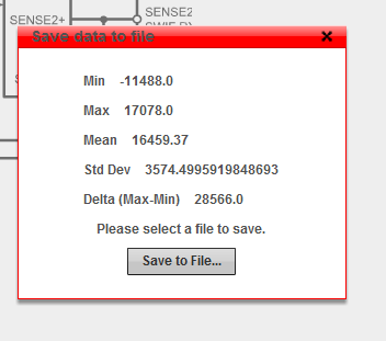

I then moved the target to 0mm from the sensor and started moving it away to verify that the target was detected properly within the 0-3mm range.  When I reached 2.84mm the output started to flicker.  I stopped and took 100 samples to see if the Rp value was varying between the DET_H and DET_L values and causing the flicker and I got this as my readings with 100 samples:
I've checked the other registers in the LMP and the values are all as we programmed them when we took the sample readings. Is there anyway writing the 0x73-0x76 registers could have caused this?  If not then what are some possible explanations for this?

  • Hi Mike,
    I had thought about that and have been working with the unit adjusting my RP_MIN/MAX values to see if it got any less noisy.
    The best results I've gotten are a delta of 66 and a standard deviation of 12 which still seems awfully noisy to me but, I was able to set the DET_H and DET_L.  I just have a much larger hysteresis than we wanted.   3mm is the switch on point(17684) and 3.3mm us the switch off(17591).  This was based on the data shown in the attached file.  I then set the unit at 2.75mm away from the target and was moving out to the turn off point of 3.3 to verify that my settings worked, at 2.93mm the units output started flickering and I took a continuous 1000 sample reading which I graphed on the second graph below.  Any ideas as to what would cause the Rp value to go deviate by a reading of 5000?

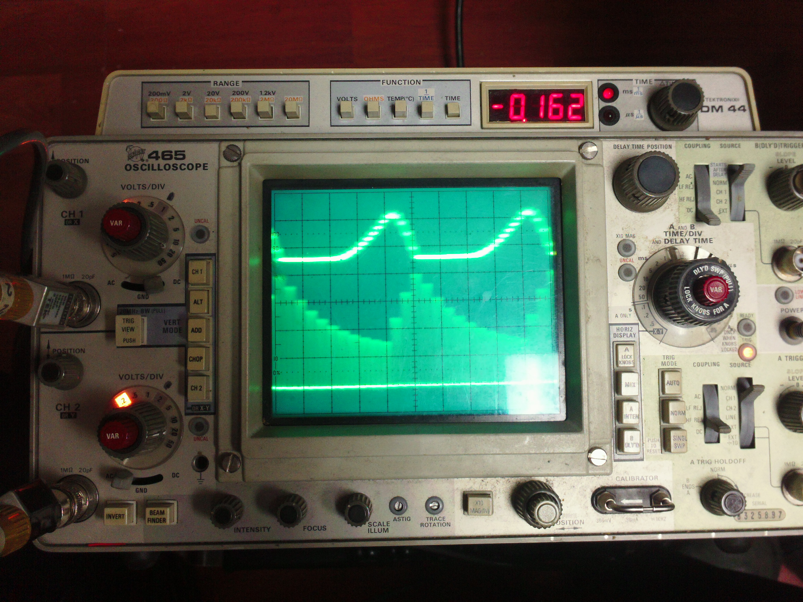

    Can you check the signal on the CFB pin? The CFB signal amplitude should be 1Vpp and is set by the CF cap. This is described in section 8.2.2.4 on page 30 of the datasheet. If the amplitude of the signal on CFB becomes too large it can cause reading like you are seeing. When I am looking at this signal I set up the scope like shown in Figure 21 and then stop the scope acquisition many times to find an accurate maximum since the signal is varying its amplitude.
    Mike
  • Hi Michael,
    I was finally able to check the amplitude of the signal on the CFB pin. See the attached, the CF cap is 150pF.
    So to get the 1Vpp the CF cap should be a value of 450pF.
  • Hi Cameron,
    Looking at your scope photo, is the top trace the CFB pin and the bottom trace the INA or INB pin?  What is the V/div for each trace?
    Can you zoom in your signal and see if it looks different?  The time base may be too long and hiding the actual shape of the signal.  It should look like the signal
    in Figure 21 of the datasheet but your signal appears to be flat on the bottom.
    Mike
  • HI Mike,
    Yes the top trace if the CFB pin, the bottom trace is INB. The CFB is set for 2V/div while INB is set for 1V/div.
    I'm fairly certain it was flat on the bottom, but I will double check about the CFB signal being flat on the bottom when I'm in the office tomorrow. What does it mean if it is flat on the bottom?

  • Hi Cameron,
    Yes, it shouldn't be flat on the bottom.  See Figure 21 in the datasheet.  Your signal is about 3V which may be causing the signal to bottom out at the low end.  Your calculation of 450pf is a good value to try.  Remember to do this while there is no target close to the LC tank.  This is because this signal is maximum when there is no target.
