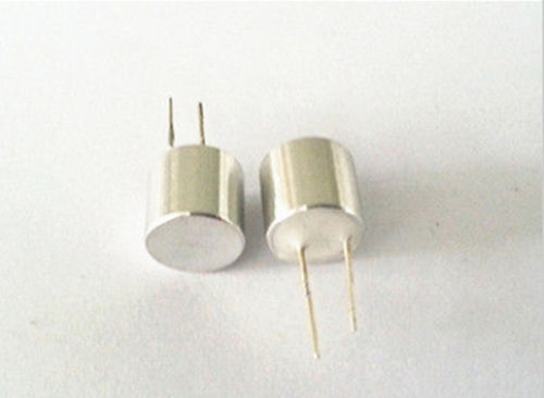

I am using the below transducer with the TDC1000. Since it has a higher input peak to peak voltage requirement I have used Intermediate frequency transformer and boosted the 40khz bursts incoming from the micro controller. Max Vp-p of this sensor is 60. The customer requires a maximum of around 3-5m with ± 2cm accuracy and a single transducer to act as both transmitter and receiver . I have used the chip in mode-1 configuration. Am I missing something?
Below are the transducer specs,
Diameter: 10 mm
Center Rated Frequency: 40 KHz
Sound Pressure Level (at 10V): ≥ 117 dB
Receiver Sensitivity (at 40KHz): ≥ -65 dB
Capacitance: 2400pF ± 25%
Maximum Input Voltage: 60Vp-p
Directivity: 60°±15° (-6dB)
Operating Temperature: -20°C~+70°C
Storage Temperature: -40°C~+85°C
