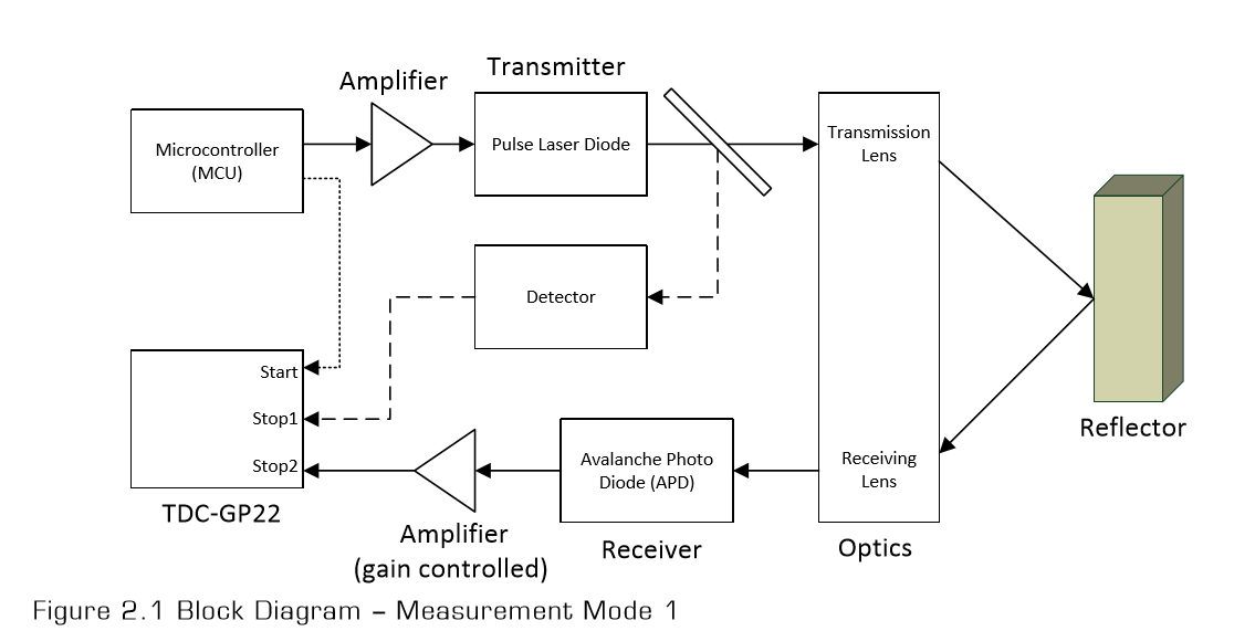

  • Hi sir i want to use this code for Arduino uno with acam GP22 TDC can you tell me what all to be modified
  • I am trying to use the GP22 Time to Digital coverter . In can anyone tell how this code works means will it send any signal to TDC to start the counter ,Stop.  How to send a signal to laser and TDC to start the pulse using this code please help me
    I want to implement this can anyone say how to use this code
