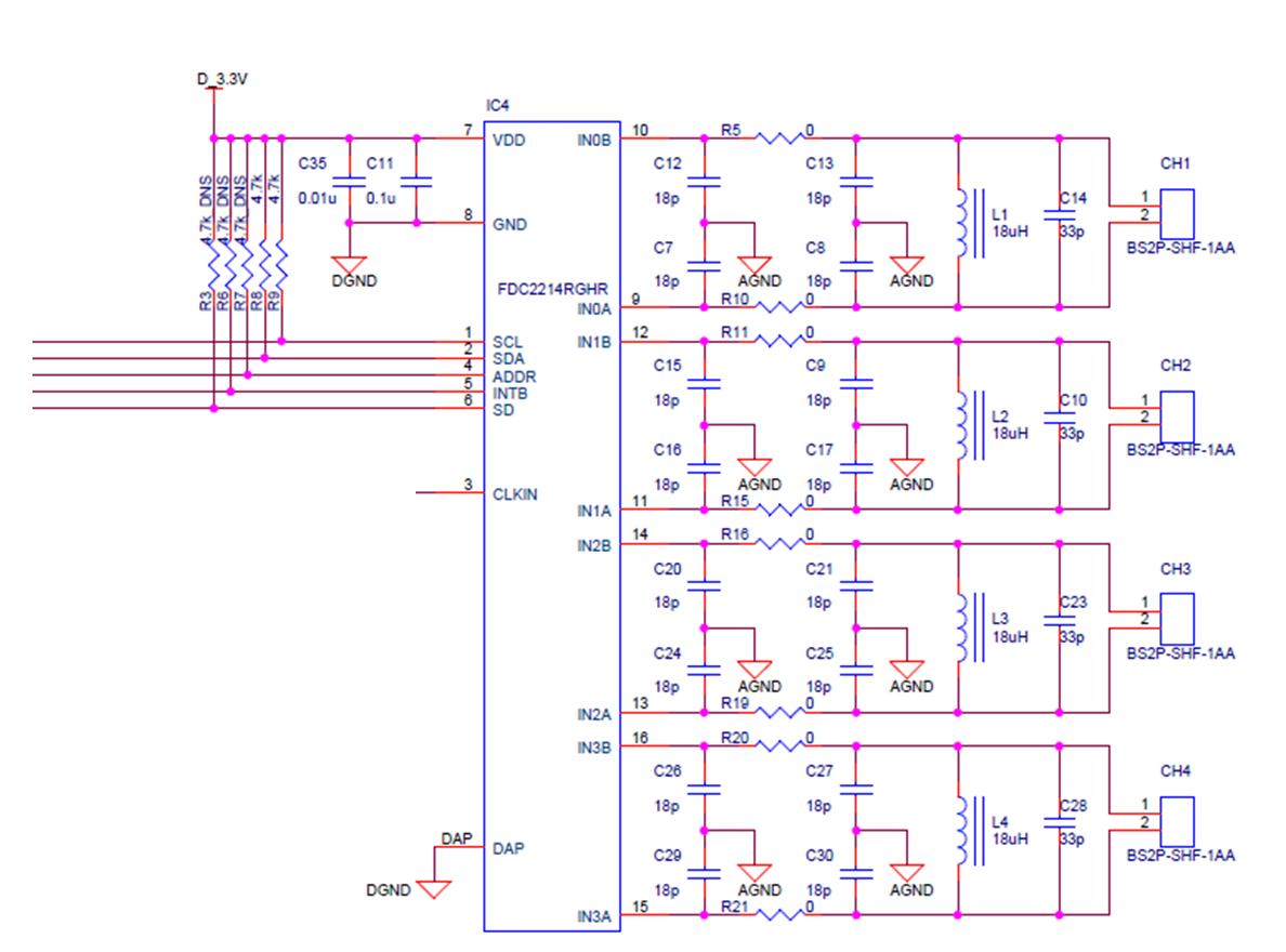

The following is our schematic of FDC2214.
What do you think what should we care about to improve measurement result. Do you have any idea?

  • Hi
    We found two types of solution for Level detection using FDC2214.
    One is single-ended measurement shown in the datasheet, which is using three electrodes (Reference environmental, Reference liquid and Level sensor).
    Another is differential sensor configuration that is shown in SNOA935A application report. (Our trial is also using differential sensor configuration).
    Which way is better for fuel gauge application?
    Thank you for your help!
    BestRegards
    From your schematic, you are using the differential approach, which is the right way to go. The figure in the datasheet is a simplified drawing.
    I've examined your data — the raw codes look reasonable to me. You should look at the delta values of the level and reference sensors, not the difference of the absolute raw codes. For example, if we look at the level sensor only, the delta from empty to full for EVM1 is 32122032-31703187=-418845, for EVM2 is 32248536-31826922=-421614. The difference between them is less than 1%. Absolute codes can differ due to variations in the placement of the board and setup, etc., but the changes in capacitance due to liquid should be repeatable.
    Yibo

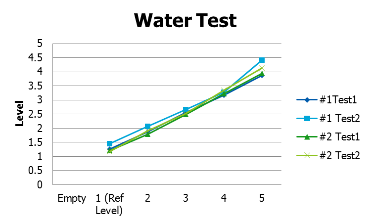

  • Hi Yibo
    We did measurement again having the delta values of the level and reference sensors as you mentioned.
    The following data that we got is for water.
    #1 Test1 Capacitance(pF)
    Water Level (cm) Level Sensor (CH2) Clev-Clev(0) Ref(CH3) Crl-Cre Level
    Empty 61.701 0 60.017 0
    1 (Ref Level) 62.114 0.413 60.345 0.328 1.259146341
    2 62.435 0.734 60.41 0.393 1.867684478
    3 62.782 1.081 60.44 0.423 2.555555556
    4 63.079 1.378 60.451 0.434 3.175115207
    5 63.417 1.716 60.461 0.444 3.864864865
    #2 Test1 Capacitance(pF)
    Empty 62.535   60.851
    1 (Ref Level) 62.911 0.376 61.162 0.311 1.209003215
    2 63.23 0.695 61.239 0.388 1.791237113
    3 63.574 1.039 61.269 0.418 2.485645933
    4 63.894 1.359 61.272 0.421 3.228028504
    5 64.24 1.705 61.284 0.433 3.937644342
    #1, #2 means the different EVM and we had test twice by each.  According to the result, we can consider they have tendency for the measurement of water level sensing.
