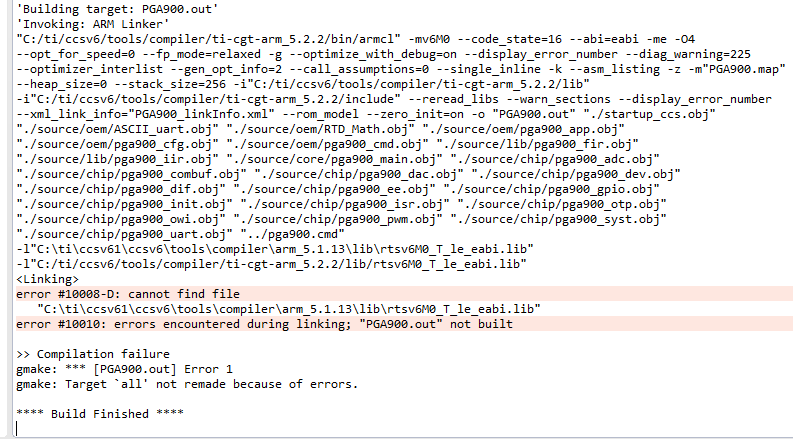

Hi. I have the same problem as the person in this thread.
https://e2e.ti.com/support/sensor/pressure/f/998/t/489322
I updated the Runtime support library directory but I still get an error when I try to build the project. It seems like the compiler is still looking in the wrong directory when building the PGA900.out file (see screen snip below). Is there somewhere else I need to update the Library directory?
My Code Composer is version 6.1.0.
  • STEP1- Install CCS version 6.1.1.00022.
    STEP2- Copy rtsv6M0_T_le_eabi.lib to C:\ti\ccsv6\tools\compiler\ti_cgt_arm_5.2.5\lib.
    STEP3- Import project as project -> Import CCS project -> browse the path
    STEP4- Go to project -> show build settings -> ARM linker -> file search path-> delete all other path except C:\ti\ccsv6\tools\compiler\ti-cgt-arm_5.2.5\lib\rtsv6M0_T_le_eabi.lib.
