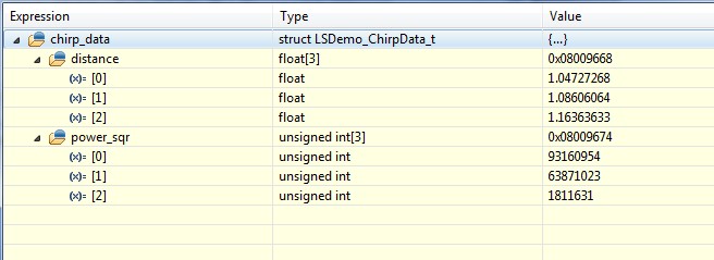

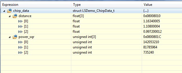

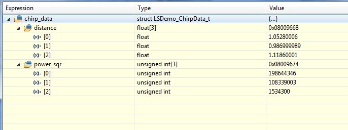

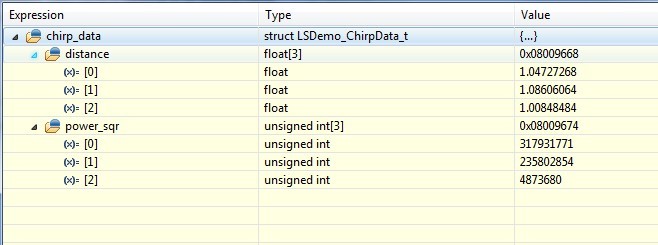

  • Feng,
    I tried your configuration: (from the Sensing Estimator snapshot you posted previously)
    #ifdef  DEMO_CONFIG_TEST
    //max range: 51.0m
    //range resolution: 5.68cm
    #define DEMOCFG_SAMPLE_RATE            7930        /* 7.93Msps */
    #define DEMOCFG_FREQ_SLOPE             435         /* x 48.28kHz/us = 21MHz/us */
    #define DEMOCFG_IDLE_TIME              600         /* 6us */
    #define DEMOCFG_ADC_START_TIME         400         /* 4us */
    #define DEMOCFG_RAMP_END_TIME          13079       /* 130.8us */
    #define DEMOCFG_RANGE_RES              0.0554
    #define DEMOCFG_NUM_ADC_SAMPLES        998
    #define DEMOCFG_FFT_SIZE               1024
    #endif
    And got the following output (running in CCS) while pointing the EVM at a wall reflector approximately 1m away:
    I then recompiled with DEMO_CONFIG 0, 1 and 3 and got the following results while pointing at the same reflector 1m away:
    Config 0:
    Config 1:
    Config 3:
