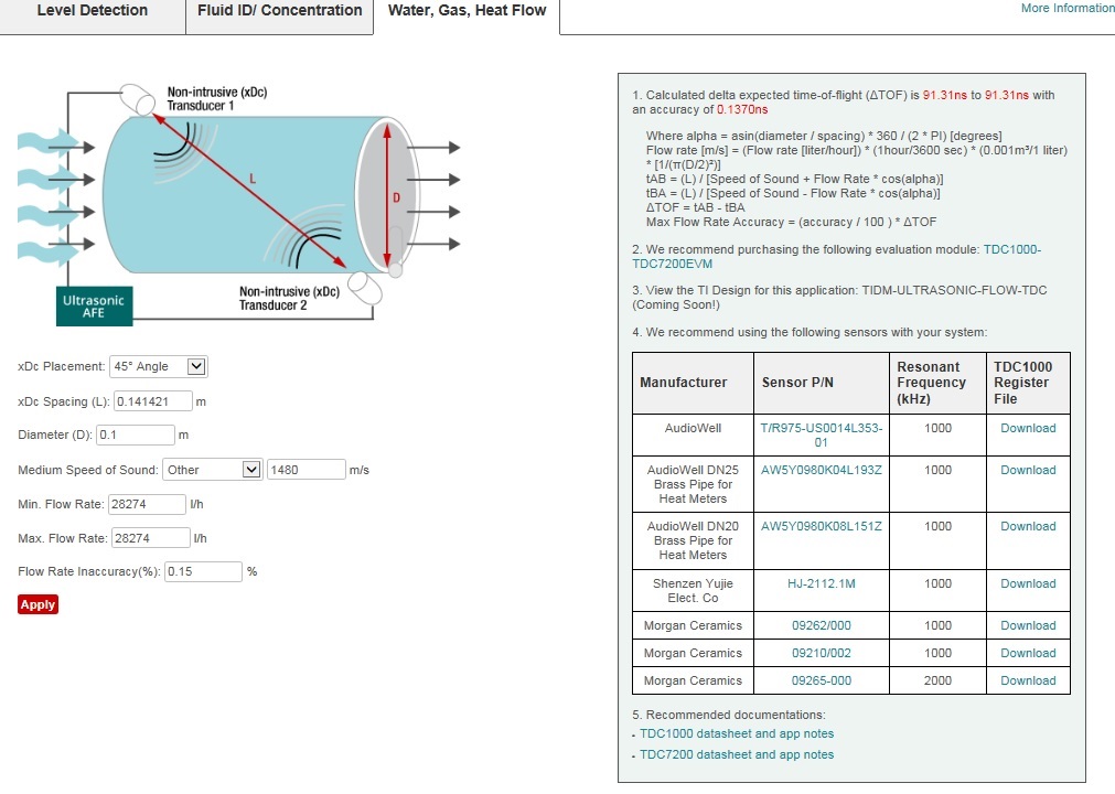

hello,
to confirm my calculation, I take the formala on wedench:
but I calculate with the formula and I do not find the webench result.
find my calculation on attached file

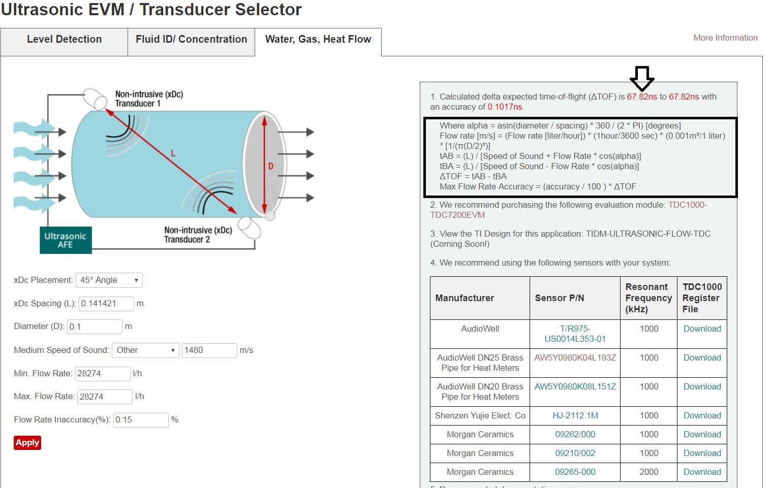

I test/versification TDC100-TDC7200EVM
to validate what I done with this board, I used the used the formula on webench designer center option sensor=> ulstrasonic sensing=> water/gas...
but my calculation give not the same result of webench result.
could you verified my calculation and/or webench and corrected me if I did an error?
thanks in advance
vivien leroy
postscript:find my calculation on attached file
Vivien,
The alpha is in degrees. However, in your worksheet you converted them into radians.
If you remove the *pi()/180, you will get the same answer,
Alfred

Vivien,
Good point! I think you brought up an easy overlooked issue in which most
programing trigonometric functions expect the input in radians instead of degrees.
We will update the alpha to radians.
Thank you for your feedback!
