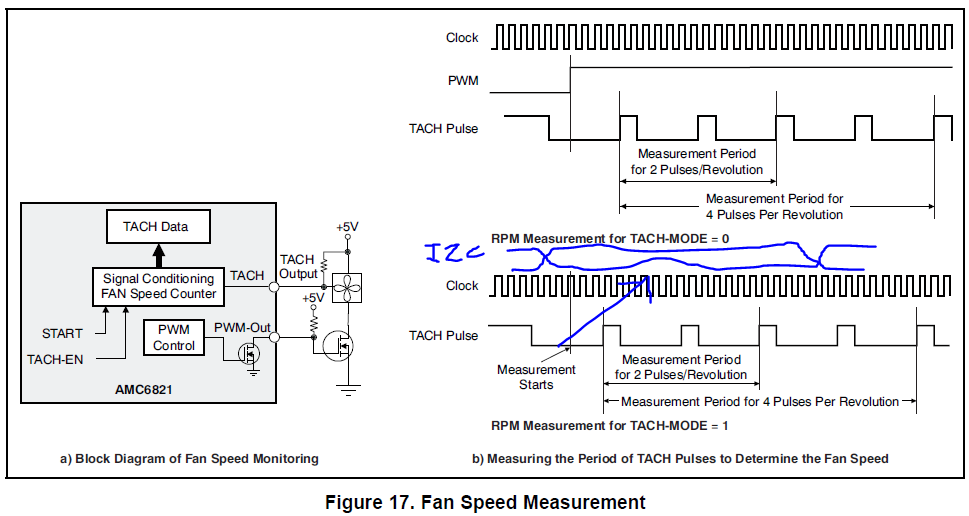

    Couple of things here:
    1. TACH reads in this case occur at speed, are continuous, and are back-to-back with little time between reads.
    2. The AMC6821 looks to be in continuous TACH update mode.
    3. The AMC6821 requires 2x TACH pulses to obtain a read per figure 17 of the datasheet.
    What happens if an I2C read occurs while the TACH is being updated? Like so:
    Don

    Thanks for the clarification.  I understand now.  The fan is ramping up and it looks like it has four discrete windows of speeds during this time frame.  What does the PWM waveform look like from the start of the TACH read cycle?  I would assume it would be at 63% DCY already and it is the physical fan speed that is lagging behind.  It is possible that the faulty TACH readings are due to the fan changing from one speed to another and should be treated as noise:
    Are you interested in the ramp-up TACH reading or steady state? I understand that your I2C clock is 100kHz but what is the actual sampling rate of your TACH reading? Is it at 1Hz like you mention before?  At higher sampling rate you will detect high frequency events like you're seeing.
    BTW, have you trying setting the TACH-FAST bit in Configuration Register 4? When TACH-FAST = 1, the TACH data reading is updated every 250ms instead of every second.  This might help.
    Do you see faulty TACH readings once the fan has settled to 63% DCY?  What I'm getting right now is that this noise occurs just during the transitional period.

  • Don,
    Our designer suspects the occasional glitches are due to a design issue.  The issue is related to the clock domain crossing of the parallel Tach value bus. This bus is for the synchronization between the internal oscillator clock and the I2C SCL. This issue may happen at the time when the low byte is requested.
    You may consider the follow workarounds:
    1. The first possible workaround, if acceptable, is to do double I2C readings and check for settled Tach value.
    2. The second workaround, if acceptable, is to read only after a new PWM value is settled.
    -Kelvin
