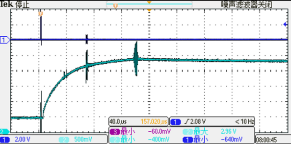

I also have some problems with the signal. I found that the COMP-IN signal in my own design showed a fall down trend in a measurement cycle, as shown in the figure:
Problem 2 Why does VCOM (or COMP-IN) falls down before the end of the test? BTW, why I can't even see the charging process when using the EVM?
Another problem is that, when I connect UART pins of my board to a TTL-to-RS232 converter(especially the supply pin), the noise on COMP-IN signal will be much larger than before, as shown in the figure:
Problem 3 I have found that the noise comes from VCOM pin, but I cant understand why. Could you please explain that?

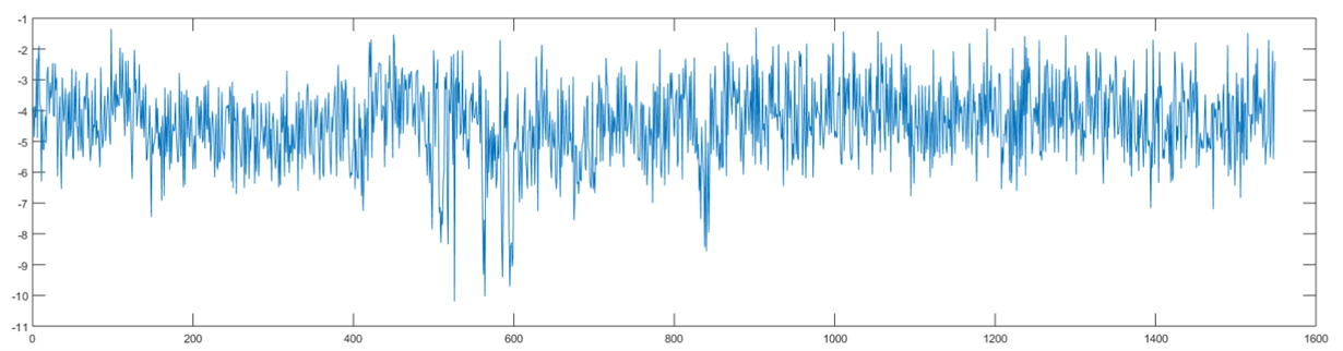

    Another problem occured today when testing, still in zero flow.
    Figure 1 is the raw data in last week's test(date: 3.06) and Figure 2 is that in today's(date:3.13). As you can see, there must be something wrong.
    Figure 1 Raw data in last week's
    Figure 2 Raw data in today's

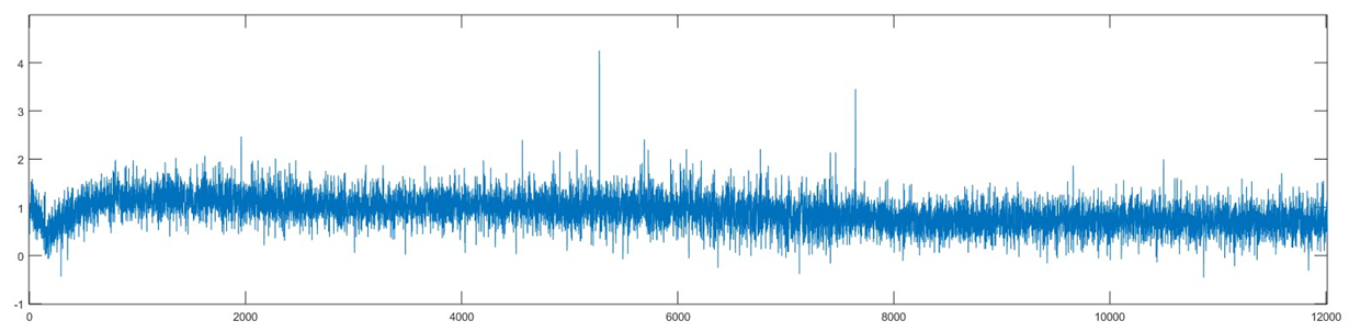

    In case of broken of sensor, I also conducted a test with my own board, figure 3 shows the result.(Worse than figure 1, but better than figure2)
    Figure 3 Today's test result with my own board
    So the sensor still works properly, as to say, the problem must lie in theEVM. But I did nothing to the board during this week, so it really confuses me. BTW, I found that VCOM seems unstable during measurement cycles, but I'm not sure if this is a normal phenomenon and can't find the reason. Have you ever come with this problem?

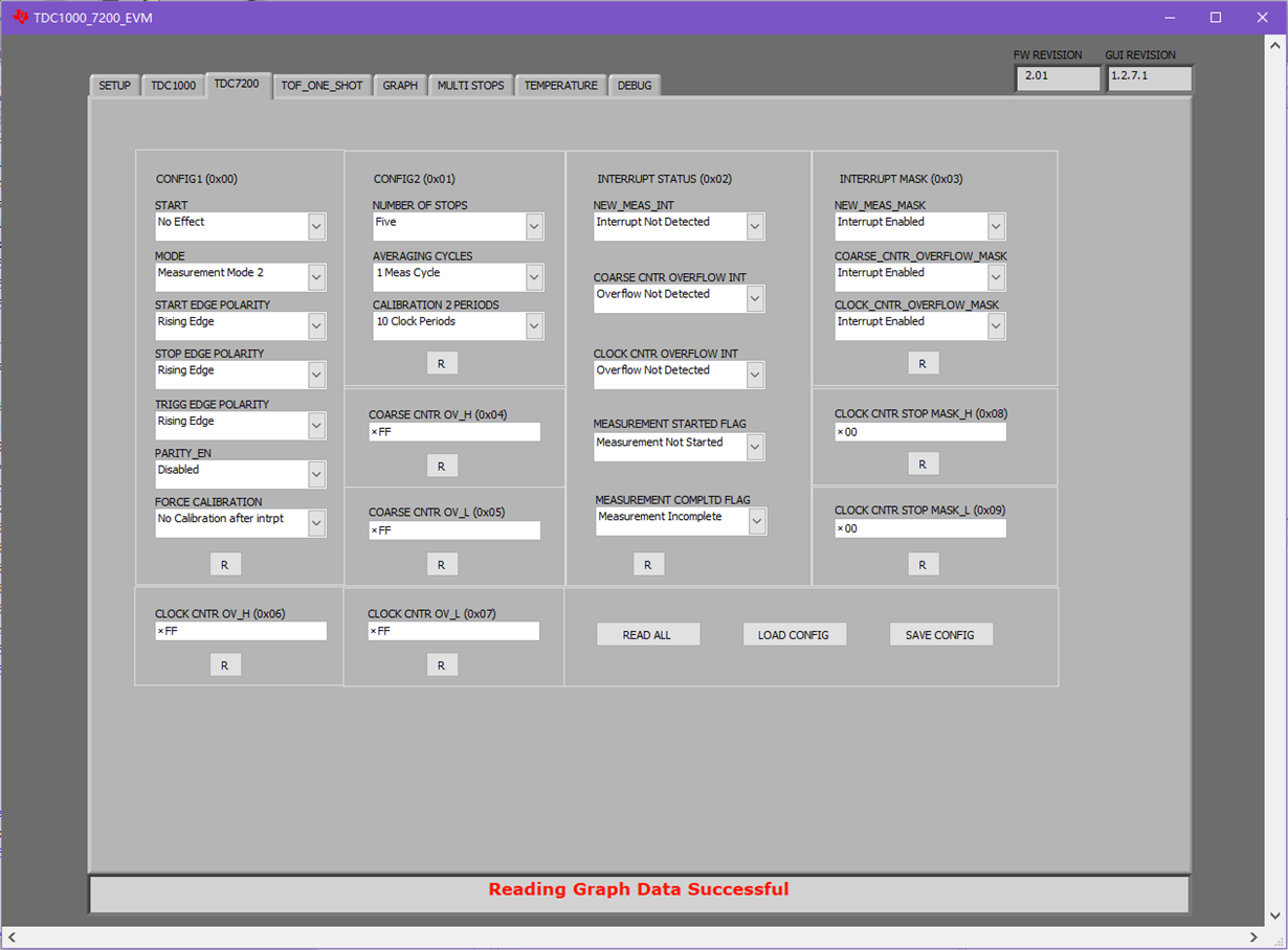

    PS. Version of the program running in the EVM is v2.01-1MHz, single TOF of my sensor is about 70 microseconds, and Figure 4~6 is configuration settings in the UI software.
    Thank you for your patience.
