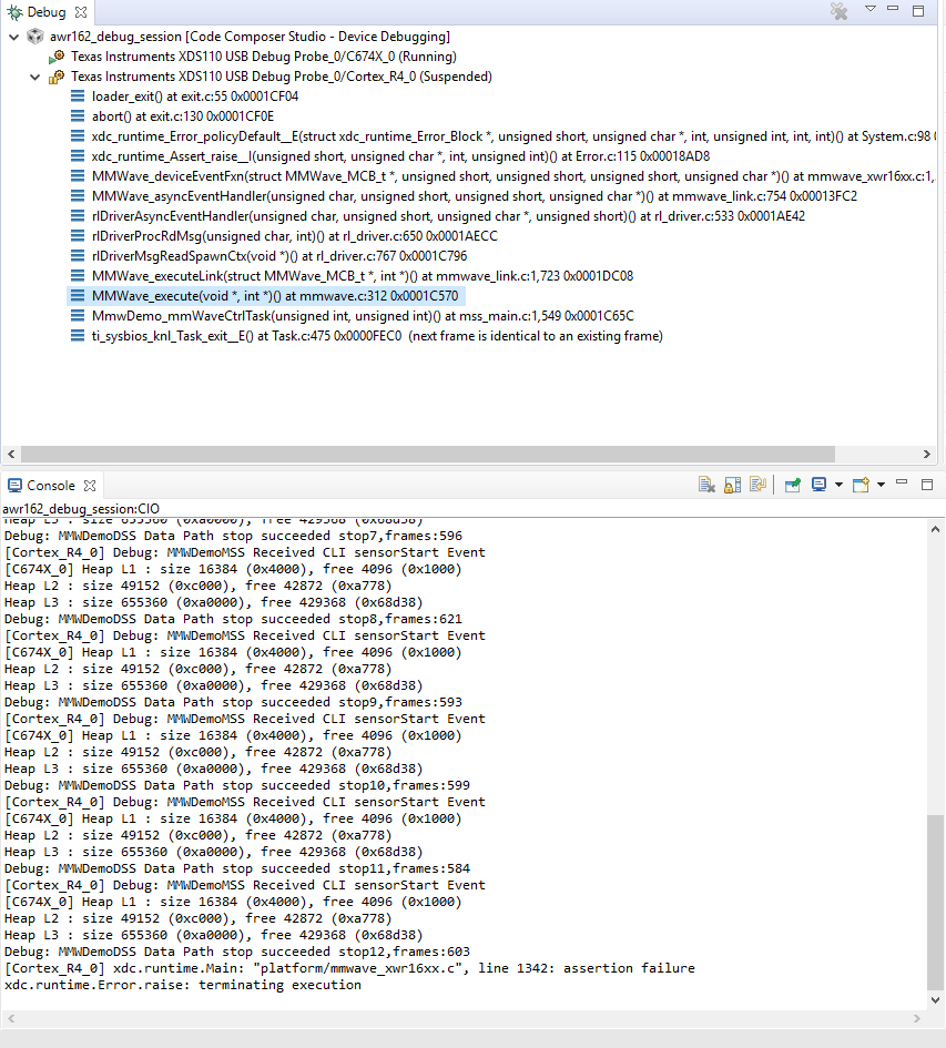

Hello;
I'm bringing up an issue I've brought up before on this forum, which has been previously locked:
https://e2e.ti.com/support/sensor/mmwave_sensors/f/1023/t/652626
After migrating to SDK v1.2, this issue seems to happen more frequently when Stopping the sensor, flushing and updating the config, then starting the sensor. Doing this process many times, usually within a minute will cause an assertion with the MMWave_execute() task. I cannot figure out why this is happening, and why it's happening more frequently with the new SDK v1.2. It has stumped me for a while now.
Any advice for debugging, or why this might be happening would be great. Here's the exact debug session of the issue:
Erik
  • Hi
    I have heard reports in the past that CLI interface through UART was not very robust.
    I think that the behavior is caused by the UART communication.
    I am not sure the mmWave SDK demo was designed to support this use case.
    Will discuss with the mmWave SDK team if they plan to support such use case in the future
    Thank you
    Cesar
  • Thanks Cesar,
    This is good to know. I will work on moving that functionality out of the CLI and see what happens.
    Do you have suggestions where stopping, re-configuring, and starting the sensor can reliably take place? What is wrong with the CLI Task that's causing issues? I don't want to move these functions to a different task and simply recreate the issue.
    Erik
  • Ideally, this should be done in the code running on the target.
    Let me check if our testing team has a similar test case.
    thank you
    Cesar

  • Cesar,
    I've moved the stopping, re configuring, and starting to a new task. I'm still evaluating the reliability, but it seems stable so far.
    However, I can't explain why, as it's a Task with identical priority/initialization as the CLI Task.
    I'll open a new thread if problems come up. Thank you for the advice.
