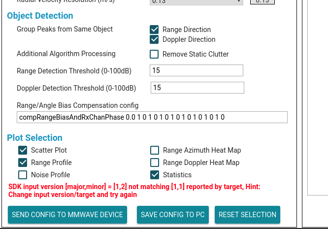

I am trying to run the demo visualizer on my AWR1642BOOST but I am having problems. The complete output from the console is:
mmwDemo:/>% *************************************************************** Skipped mmwDemo:/>% Created for SDK ver:01.01 Skipped mmwDemo:/>% Created using Visualizer ver:2.0.0.0 Skipped mmwDemo:/>% Frequency:77 Skipped mmwDemo:/>% Platform:xWR16xx Skipped mmwDemo:/>% Scene Classifier:best_range_res Skipped mmwDemo:/>% Azimuth Resolution(deg):15 Skipped mmwDemo:/>% Range Resolution(m):0.044 Skipped mmwDemo:/>% Maximum unambiguous Range(m):9.02 Skipped mmwDemo:/>% Maximum Radial Velocity(m/s):1 Skipped mmwDemo:/>% Radial velocity resolution(m/s):0.13 Skipped mmwDemo:/>% Frame Duration(msec):100 Skipped mmwDemo:/>% Range Detection Threshold (dB):15 Skipped mmwDemo:/>% Doppler Detection Threshold (dB):15 Skipped mmwDemo:/>% Range Peak Grouping:enabled Skipped mmwDemo:/>% Doppler Peak Grouping:enabled Skipped mmwDemo:/>% Static clutter removal:disabled Skipped mmwDemo:/>% *************************************************************** Skipped mmwDemo:/>sensorStop Done mmwDemo:/>flushCfg Done mmwDemo:/>dfeDataOutputMode 1 Done mmwDemo:/>channelCfg 15 3 0 Done mmwDemo:/>adcCfg 2 1 Done mmwDemo:/>adcbufCfg -1 0 0 1 0 Error: Invalid usage of the CLI command Error -1
I am using SDK 1.1
I was also trying to use other SDK versions but system just allow me to use SDK 1.1.
This is the SDK 1.2 version of the command. You will need to install and use mmWave SDK 1.2.
-dave
I managed to make it work using the UNIFLASH setting up the sdk 1.2 demo to the AWR1642BOOST
Thank you!
