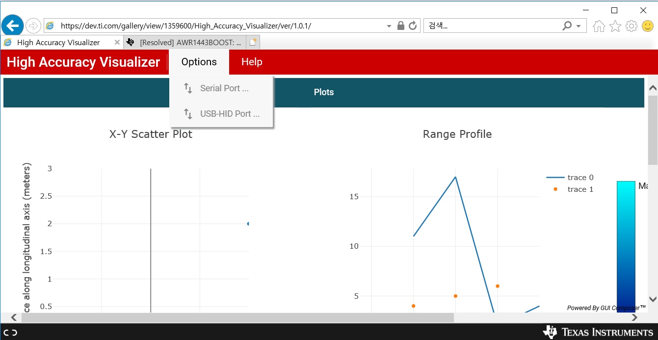

Hi everyone, im trying to use Ti demo " high accuracy 16xx".
I've seen the user's guide and tried it one by one, but I get an error.
I've tried several versions of the SDK but it has not.
Can somebody help me?
Thank you
    The visualizer is for mmwave demo, please use the high accuracy visualizer. The link is available in the high accuracy lab user guide. Direct link is pasted below:
    dev.ti.com/.../
    Michelle
  • I entered the linked site as you said, but the port connection is not active.
    What should I do?
    Thank you
  • This problem has been resolved. However, I want to know what the point on the x-y scatter plot means. If the antenna is blocked by 1m from the inside by hand, the value will be 1 ~ 4m. please help me. Thank you!! Regards, Hyunsik
    In high accuracy lab, only the range information is displayed. Therefore even it's is x-y plot, it is displaying only the distance along longitudinal direction. I'm not clear what the setup is like about "blocked by 1m from the inside by hand". Please give more details. Thanks
    Michelle
  • Hi
    Looking at the picture below, the distance of the object blocking the sensor is not 1m.
    However, under the captured picture, the distance is 3.9m. Can I see why? And where can I find a manual on how to configure?
    Hyunsik
    How much radar signal is reflected depends on the object's RCS(reflection cross section). Radar signals can even pass through walls, so the stack of paper does not really mean it has reflected the radar signal to make radar device consider it as an object. An ideal reflector like the corner reflector or simply a piece of metal plate is be suggested.
