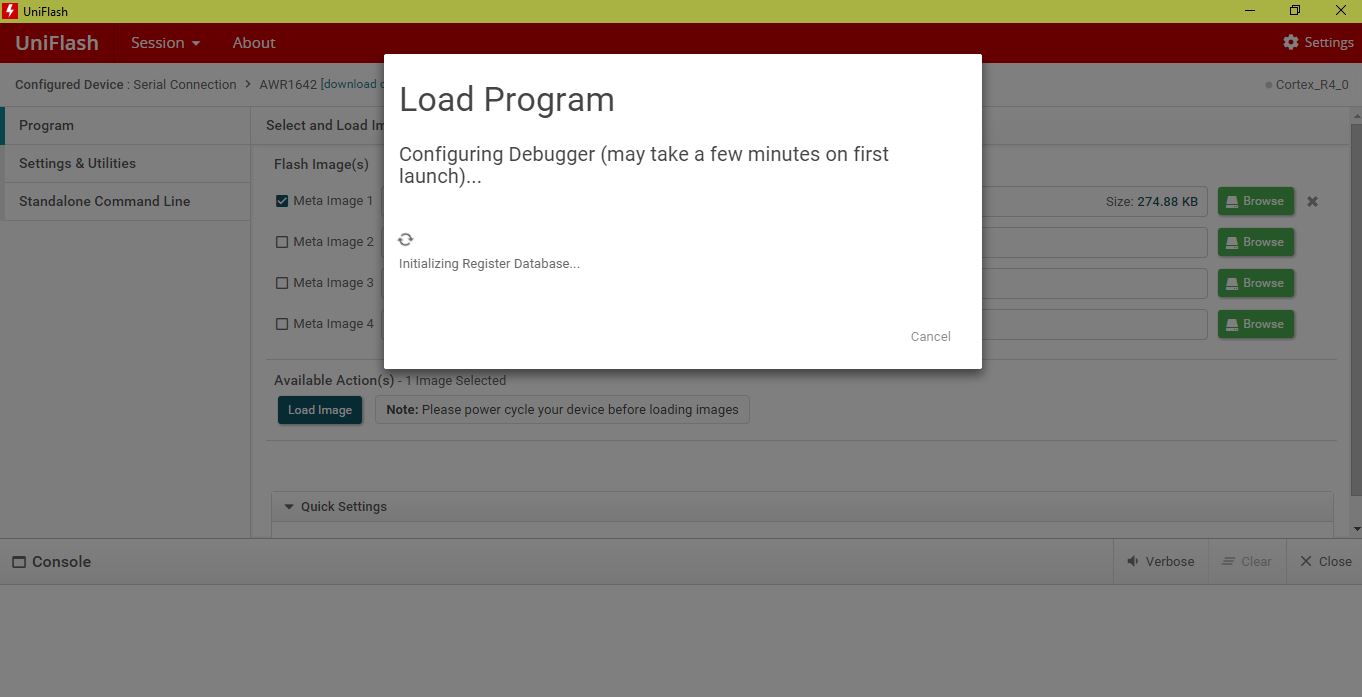

I'm not able to flash the ccsdebug file on awr1642boost. Both the red and orange led are on. I'm able to detect the comports but in the home screen of uniflash, autodetect or manual detect are not able to detect the device. Also it's drawing a current of only 0.32 A from a 5V supply that i'm using. Also when i try to upload, it gets stuck at the screen sent in the attachment, showing 'Initializing Register Database...'. I have waited for more than 20 mins but nothing happened.
Also when i tried to test the connection using CCS using the steps mentioned in the image attached, i got the following message in the 'test connection' window.

Kindlly help asap.
