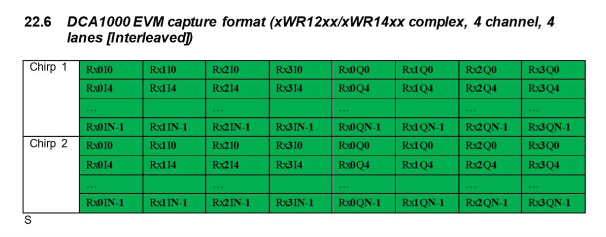

Hi, I have got the DCA1000 EVM and the raw data from it. But I find the data format in DCA1000 EVM is not the same as the data from TSW1400 EVM.  So where can I find the data format in DCA1000 EVM. Thank you !

  • This is the data format I have found in data sheet, and I write a matlab code to calculate I/Q data. But that doesn't look right.  Is there anything wrong with my program
    % change based on sensor config %---------------------------------------------------------------------
    numADCBits = 16; % number of ADC bits per sample
    numLanes = 4; % do not change. number of lanes is always 4 even if only 1 lane is used. unused lanes
    isReal = 0; % set to 1 if real only data, 0 if complex dataare populated % with 0
    %% read file and convert to signed number
    % read .bin file
    fid = fopen(fname,'r');
    adcData = fread(fid, 'uint16'); % compensate for offset binary format
    adcData = adcData - 2^15;
    fclose(fid);
    %% organize data by LVDS lane
    % reshape data based on two samples per LVDS lane
    adcData = reshape(adcData, numLanes*2, []);
    % combine real and imaginary parts of complex number
    adcData = adcData([1,2,3,4],:) + sqrt(-1)*adcData([5,6,7,8],:);
    cdat = adcData;
  • I have solved the problem, I share my code here! And thank you for your help
    % read .bin file
    fclose(fid);
    % Bin_adcData = dec2bin(adcData,16);
    adcData(adcData>2^15)=adcData(adcData>2^15)-2^16;
    cdat = adcData;
