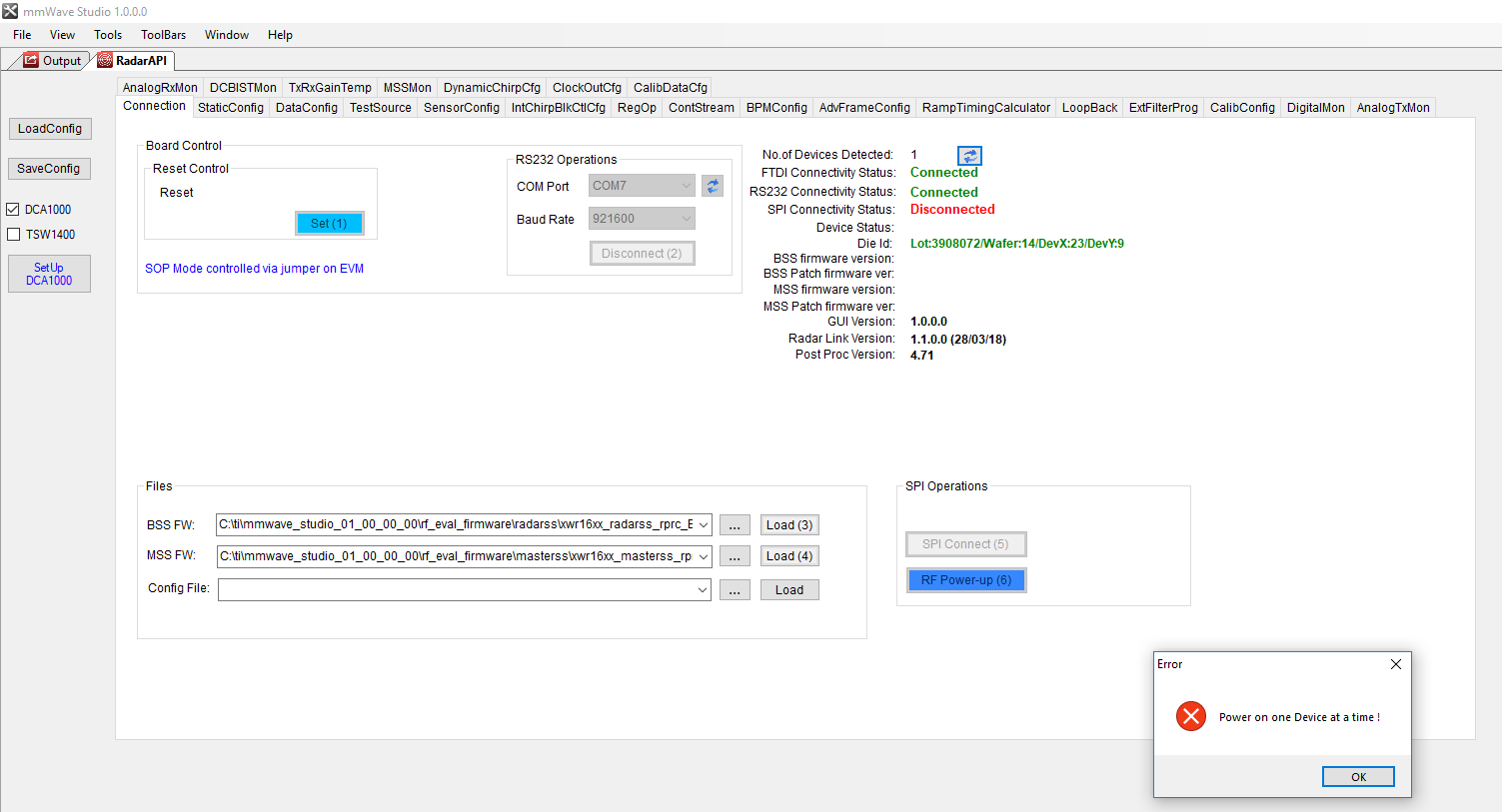

AWR1642BOOST: can't get it work with DCA1000EVM
Part Number: AWR1642BOOST
Other Parts Discussed in Thread: AWR1642, DCA1000EVM
I follow the instructions in "DCA1000_Quick_Start_Guide.pptx" and "mmwave_studio_user_guide.pdf".  when I do the step#5 I got an error message as shown in the picture. Please note that even step#3 and #4 don't throw me error messages, but the mmwave_studio doesn't show the version number.  I used binaries for AWR1642 ES1.

  • Hi Cesar,
    I followed the online version of Quick Start Guide. I think I still got into the same situation. It look like SPI is not connected and the "SPI Connect(5)" button is greyed out.
    the log is attached as well.

  • Hello Xinsi,
    Can you manually power cycle the boards, click on the "set" and then click on the RS232 "Connect" ? If you can share that snapshot that would be helpful.
    Vivek
  • ethernet capture dump.zipHi Vivek,
    That is what I did from the beginning!   I am able to get a bit further on my side.  for now the problem looks like I don't get data from DCA1000EVM. With wireshark, I am able to see house PC is communicating to the DCA1000EVM on config port 4096 only, no activity on data port. Can you please check the wireshark data to see what is going on? wiredata capture is attached.  the mmwave_studio is below:

    [09:07:10]  [RadarAPI]: ar1.SelectCaptureDevice("DCA1000")
    [09:07:10]  [RadarAPI]: passed
    [09:07:10]  SelectCaptureDevice Success
    [09:07:11]  [RadarAPI]: StatusDCCard Event Registered
    [09:07:11]  [RadarAPI]: Status: Passed
    [09:07:11]  [RadarAPI]: ar1.CaptureCardConfig_EthInit("192.168.33.30", "192.168.33.180", "12:34:56:78:90:12", 4096, 4098)
    [09:07:13]  Ethernet Cable is disconnected Please check.....!!!
    [09:07:13]  CaptureCardConfig_EthInit Success

    [09:07:17]  [RadarAPI]: Status: Passed
    [09:07:17]  Frame start async event received!
    [09:07:18]  Frame End async event received!
    [09:07:18]  [RadarAPI]: Frame Ended
    [09:07:19]  Please wait for a few seconds for Packet reorder utility processing .....!!!!
    [09:07:19]  [RadarAPI]: Packet Reorder Utility Started...please wait...
    [09:07:19]  [RadarAPI]: ar1.PacketReorderZeroFill("C:\\ti\\mmwave_studio_01_00_00_00\\mmWaveStudio\\Scripts\\..\\PostProc\\adc_data_Raw_0.bin", "C:\\ti\\mmwave_studio_01_00_00_00\\mmWaveStudio\\Scripts\\..\\PostProc\\adc_data.bin", "C:\\ti\\mmwave_studio_01_00_00_00\\mmWaveStudio\\Scripts\\..\\PostProc\\pktlogfile.txt")
    [09:07:24]  [RadarAPI]: Packet Reorder Utility process completed!
    [09:07:34]  Packet reorder utility processing done.....!!!!
    [09:07:34]  Please wait for a few seconds for matlab post processing .....!!!!
    [09:07:34]  [RadarAPI]: ar1.StartMatlabPostProc("C:\\ti\\mmwave_studio_01_00_00_00\\mmWaveStudio\\Scripts\\..\\PostProc\\adc_data.bin")
    [09:07:35]  [RadarAPI]: Error:
    [09:07:35]
    [09:07:35]  ... MWMCR::EvaluateFunction error ...
    [09:07:35]  21-Jun-2018 09:07:35: The file C:\ti\mmwave_studio_01_00_00_00\mmWaveStudio\Scripts\..\PostProc\adc_data.bin is empty. Please capture more data.,1,
    [09:07:35]  Error in => process_adc_data.m at line 52.
    [09:07:35]
    [09:07:35]  ... Matlab M-code Stack Trace ...
    [09:07:35]      at
    [09:07:35]  file C:\Users\xlin\AppData\Local\Temp\XLin\mcrCache8.5.1\Matlab0\Logging\log_status.m, name log_status, line 32.
    [09:07:35]      at
    [09:07:35]  file C:\Users\xlin\AppData\Local\Temp\XLin\mcrCache8.5.1\Matlab0\Processing_functions\read_adc_data.m, name read_adc_data, line 28.
    [09:07:35]      at
    [09:07:35]  file C:\Users\xlin\AppData\Local\Temp\XLin\mcrCache8.5.1\Matlab0\MatlabPostPr\process_adc_data.m, name process_adc_data, line 52.
    [09:07:35]
    [09:07:35]
    [09:07:35]  Trace:
    [09:07:35]     at MathWorks.MATLAB.NET.Utility.MWMCR.EvaluateFunction(String functionName, Int32 numArgsOut, Int32 numArgsIn, MWArray[] argsIn)
    [09:07:35]     at MathWorks.MATLAB.NET.Utility.MWMCR.EvaluateFunction(Int32 numArgsOut, String functionName, MWArray[] argsIn)
    [09:07:35]     at MatlabPostProcGui.MatlabPostProcGUIClass.process_adc_data(MWArray adc_file_name, MWArray force_cont_stream_mode)
    [09:07:35]     at AR1xController.frmAR1Main.iStartMtlabPostProc()
    [09:07:45]
    [09:07:45]  ***Script completed successfully.***
    [09:18:28]  [RadarAPI]: ar1.SelectCaptureDevice("DCA1000")
    [09:18:28]  [RadarAPI]: passed
    Xinsi
  • 2766.ethernet capture dump.zip
    re-attached the  wireshark capture  again! the one in the previous post is in a weird location.
  • After I changed SW2.5 to CONFIG_VIA_SW, I see the data being sent to the house PC via wireshark! however I still got the same error as before which is complaint about "adc_data.bin is empty" as below-
    mmwave studio log data.rtf
  • HI,
    We were communicated that this issue was resolved.
    Can you please share with the forum what the issue was?
    thank you
    Cesar
  • I make it working on a different PC which is running Windows 7 . The one I have issue with is running Windows 10.
