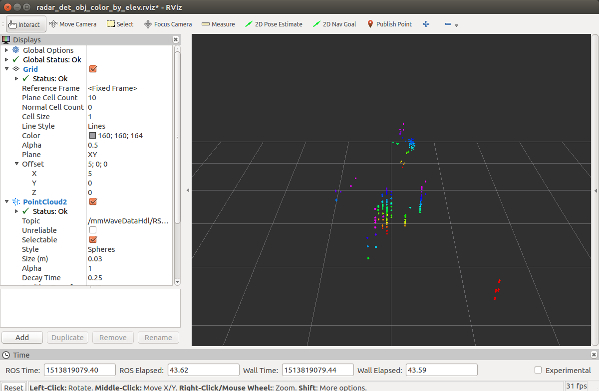

I was displaying Rviz with the following command.
>cd ~/catkin_ws
>source devel/setup.bash
>roslaunch ti_mmwave_rospkg rviz_1443_3d.launch
I have been displaying 3D point clouds all the time.
The last one to show about a month ago.
But today, I runed the same command to bring Rviz up,
but the point cloud is no longer displayed.

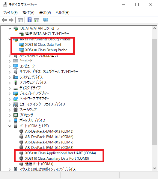

    When I used DCA1000EVM, I put some drivers on the machine.
    At that time, it may have updated the driver of XDS110.
    I have restored the serial port setting, but do I also need to re-install the driver?
    Because it went well when I did it in the VirtualxBox environment three months ago on another PC.

    The PC using ROS was dual boot, and it was used with Windows 10.
    In Ubuntu and Windows 10, the same version of the tool box was originally included.
    But, when I used DCA1000EVM on Windows 10 side, I installed the driver and updated the red  frame above,
    even though it was not necessary.
    It seems that this was the cause.
    I removed the driver of XDS once from Windows 10 side, downloaded from below and put it in again.
    <processors.wiki.ti.com/.../XDS_Emulation_Software_Package>
    Then I stop Windows 10, start up Ubuntu, with the board that was flushedopen SDK v1.2.0.5 out-of-box demo.
    The point cloud was displayed normally.
