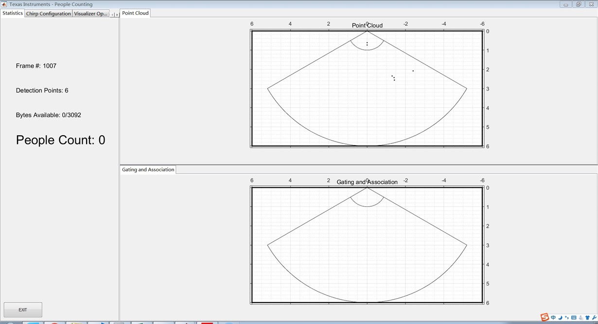

hello,I bought a Awr1642 boost ES2.0.I want to run the pplcount demo,but I always failed.
1.First I install SDK 2.0 and  try to use C:\ti\mmwave_industrial_toolbox_2_5_0\labs\lab0011-pplcount\lab0011_pplcount_quickstart\xwr16xx_pcount_lab.bin,then the serial had no response,and I can't send the config.I use the Tera Term to connect the board, and it can be connected but can't show anything.

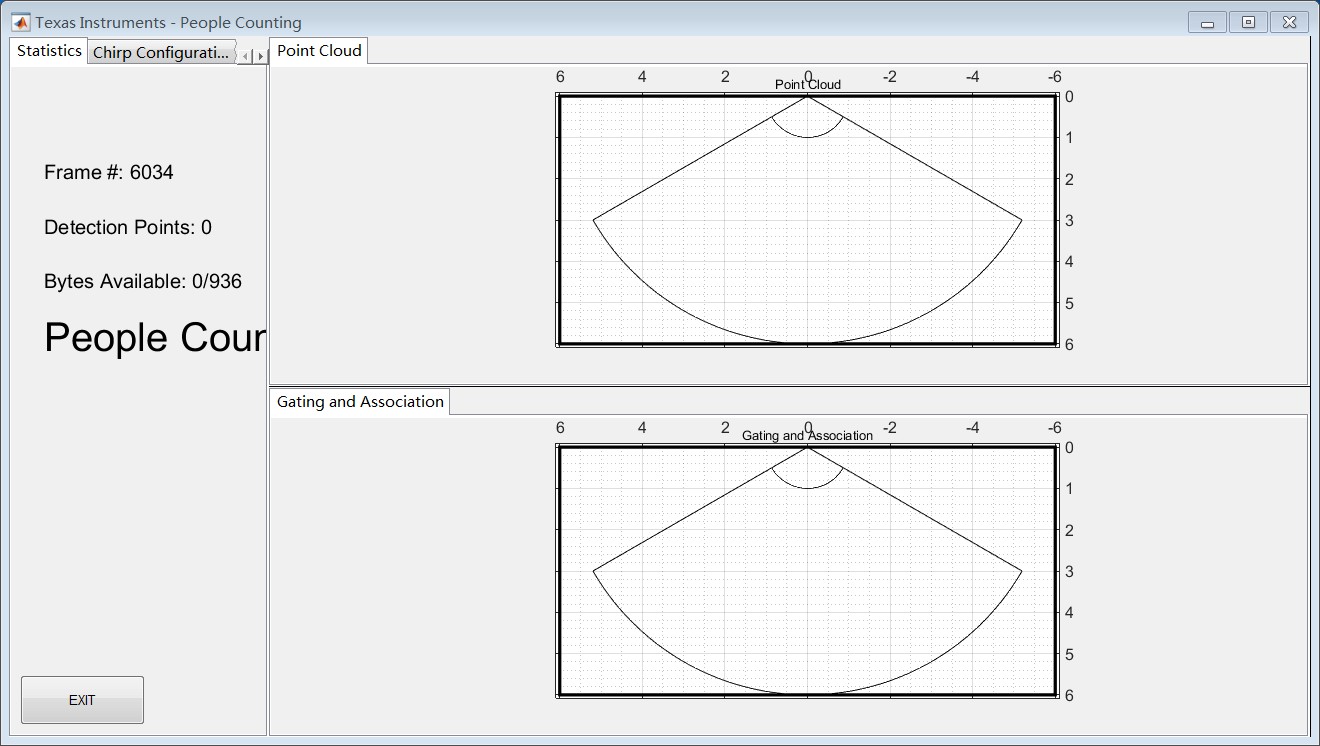

2.I was trying to compile the source code, your address of TI CGT compile 7.4.16 is wrong ,so I had to use compile 8.1.2. CCS successfully generate the bin file. When I run the GUI,I just saw the increasing number of Frame.No point cloud no people count number.
3.When I found the theory of traffic monitoring demo is same as people counting,so I burn the trafiic bin file. The GUI show the point cloud ,but no Gating and Assosiation .I careful analized the serial data ,I found no Target List TLV data,only point cloud data.
I have adjust the config parameters,but no poeple counting message only point cloud.
Can you tell how to run the people counting demo?I am very anxious. I can exclude the hardware error because i can run other demo.
