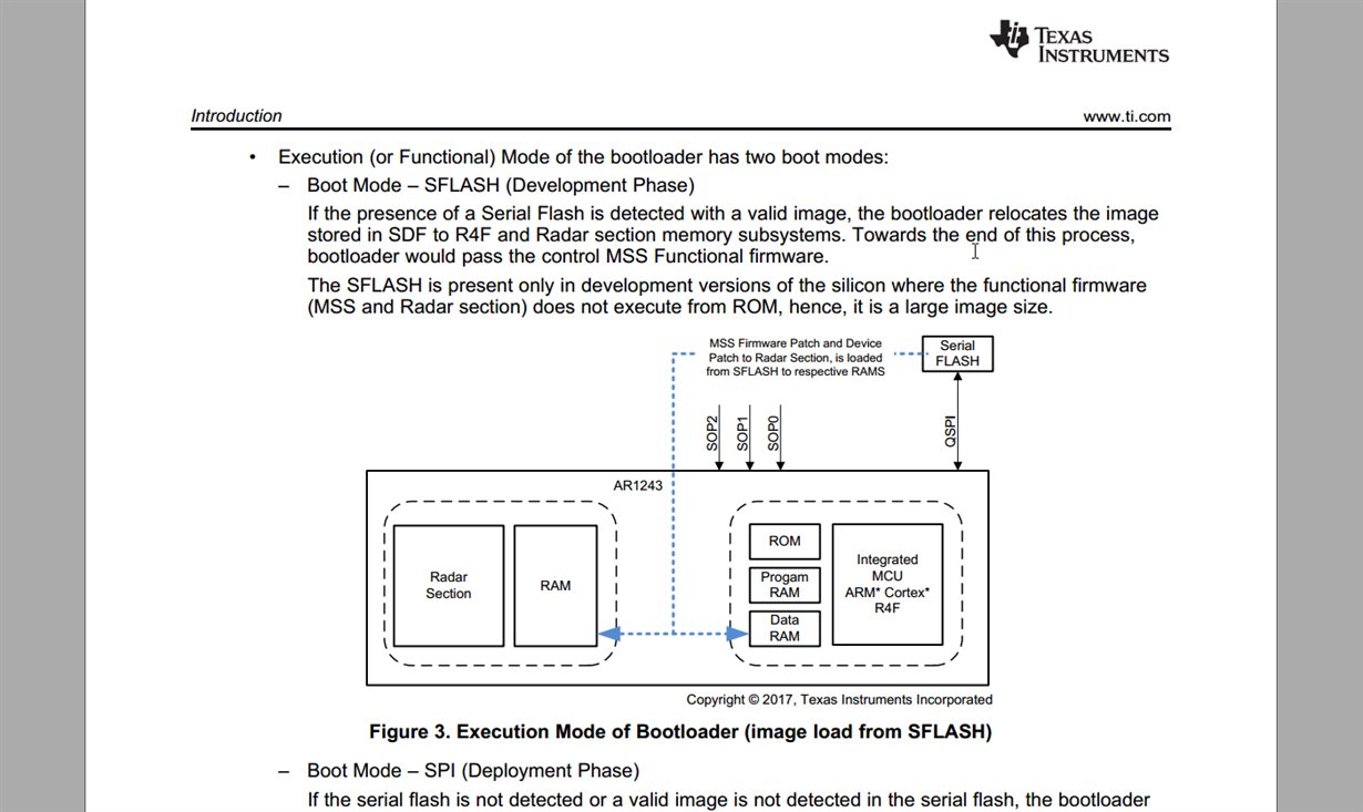

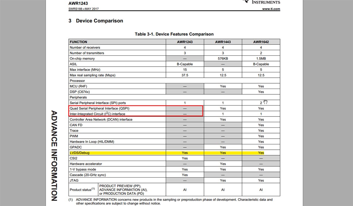

AWR1243 support SFLASH boot mode:
But according to the description of the datasheet,NO QSPI or I2C interface in AWR1243:
Is there any or no?
