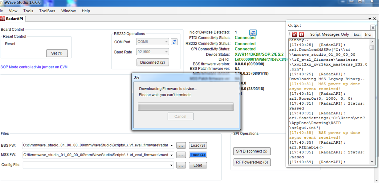

hi,
I am using mmWave Studio with DCA1000 and iwr1443 and when running the Capture demo,i do this with the help of the DCA1000 Quick Start Guide.After clicking the run button,it load the BSS FW and MSS FW again, and it fails as thepicture shows.
 Can anyone help me.?Thanks in advance.

    The folder directory you showed is not the default one, it should be under C:\ti\mmwave_studio_01_00_00_00\rf_eval_firmware
    Another thing is that the output window didn't scroll down to show what error message is.
    Please re-install mmwave studio and use default directory as suggested. Let me know how it goes.

    Thank you so much!I have solved the problem  caused by my repeatd loading.I find it that it works well after I click the run button without loading the  folder.
