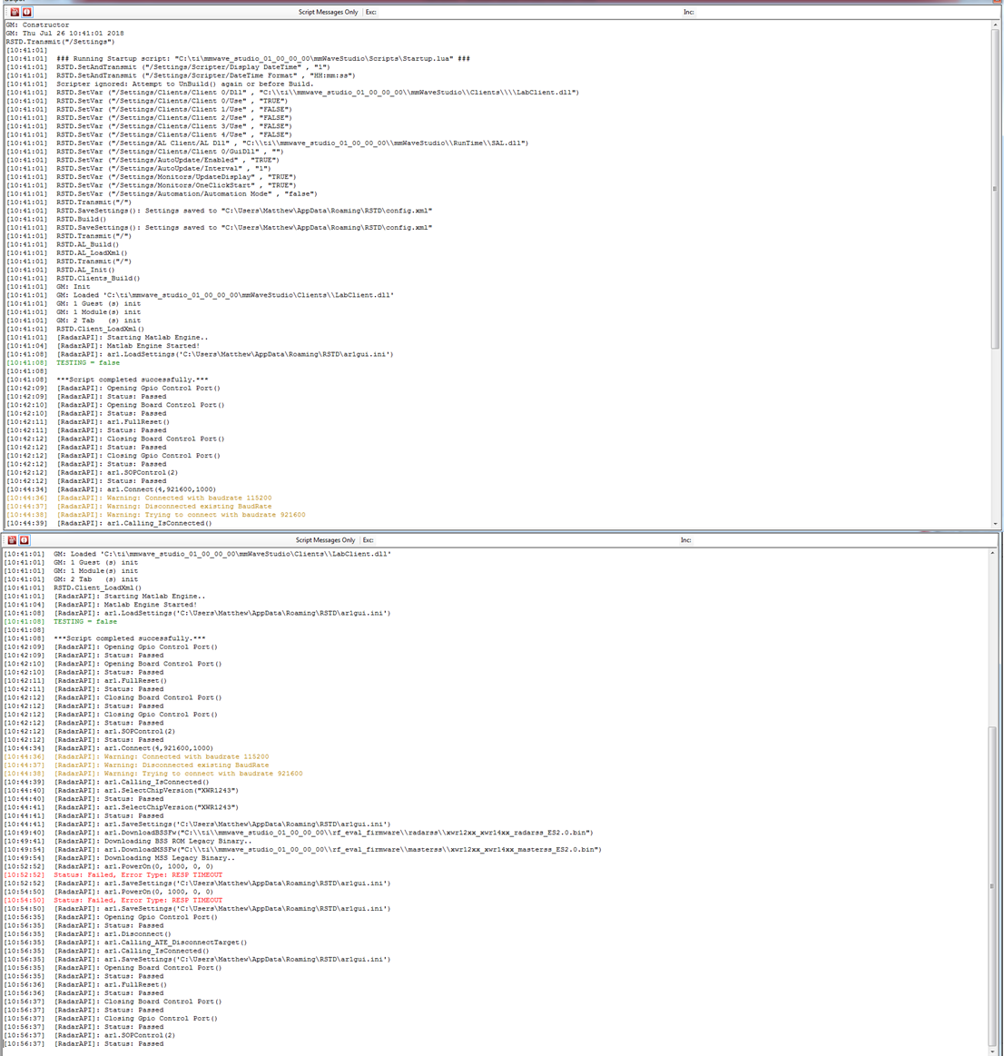

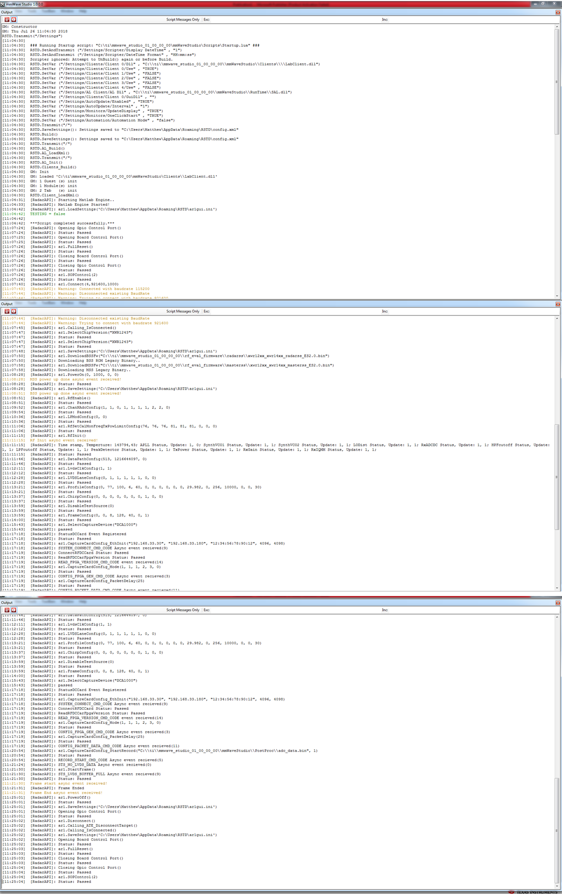

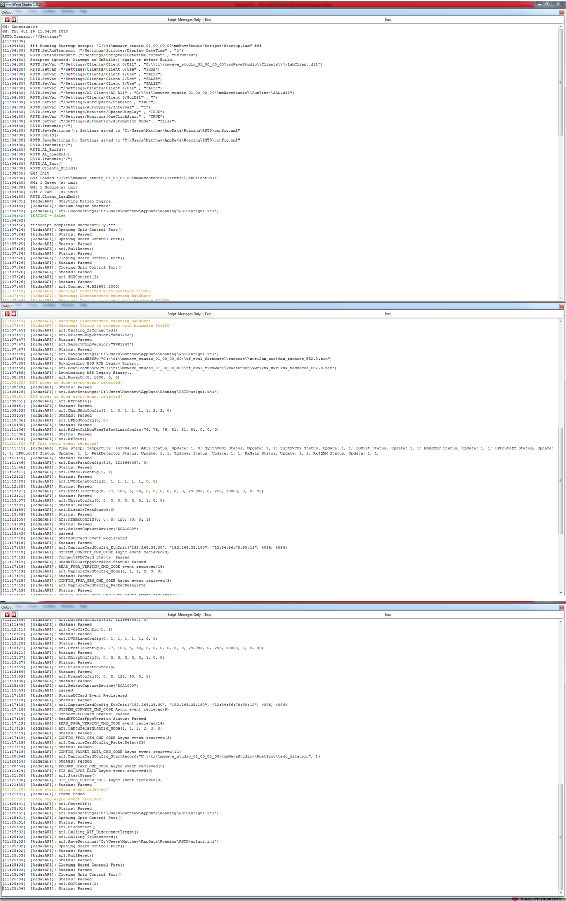

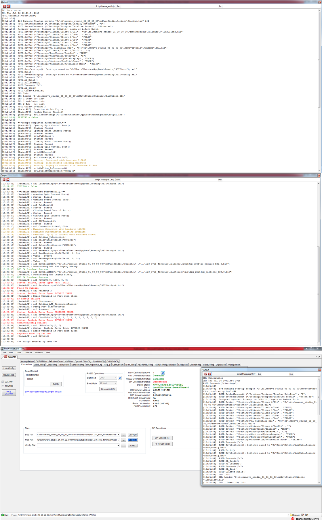

I have been attempting to run the data capture demo script that is included in mmWave studio. This threw up a few errors yesterday (That I didn't record) and then worked for two runs of the script with seemingly no alteration from the runs that gave errors..

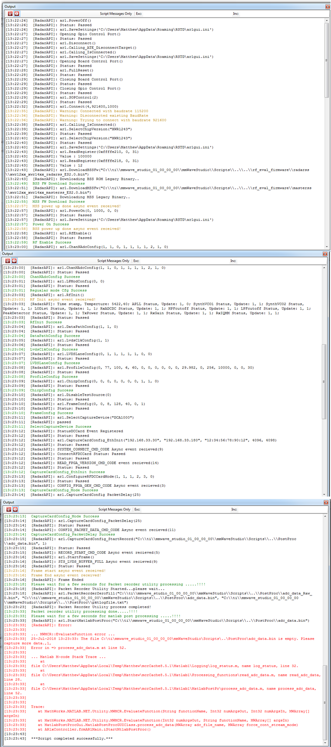

Returning today the same errors appeared and then disappeared eventually. However, an error now appears that says no data has been captured, this is true as the dump file specified in the sensor config tab has a size of 0Kb when i checked it. The FPGA_ERR_LED is also lit at this point until a board reset is issued from the connections tab.
I have attached the logs for this run and also screenshots of the output window that may be easier to read.

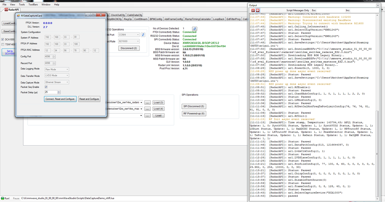

After this I attempted to perform the data capture manually. The process followed through fine until the set up DCA1000 step. In this step initially no FPGA version appear, when the connect,reset and configure button is hit there is also no FPGA version at first. When disconnected is then pressed and the connect,reset and configure button is hit again the FPGA version then updates. However, the arm DCA1000 button is still greyed out. Upon pressing trigger frame the same LED lights up and again no data is collected.
I have checked that there is a local area network present with the correct IP address. Also, in the process of getting rid of the initial errors the FPGA reset button was pressed on the DCA1000 board if this is important.
Any help will be appreciated.

RSTD.Transmit("/Settings")
[13:14:07]
[13:14:07]  ### Running Startup script: "C:\ti\mmwave_studio_01_00_00_00\mmWaveStudio\Scripts\Startup.lua" ###
[13:14:07]  RSTD.SetAndTransmit ("/Settings/Scripter/Display DateTime" , "1")
[13:14:07]  RSTD.SetAndTransmit ("/Settings/Scripter/DateTime Format" , "HH:mm:ss")
[13:14:07]  Scripter ignored: Attempt to UnBuild() again or before Build.
[13:14:07]  RSTD.SetVar ("/Settings/Clients/Client 0/Dll" , "C:\\ti\\mmwave_studio_01_00_00_00\\mmWaveStudio\\Clients\\\\LabClient.dll")
[13:14:07]  RSTD.SetVar ("/Settings/Clients/Client 0/Use" , "TRUE")
[13:14:07]  RSTD.SetVar ("/Settings/Clients/Client 1/Use" , "FALSE")
[13:14:07]  RSTD.SetVar ("/Settings/Clients/Client 2/Use" , "FALSE")
[13:14:07]  RSTD.SetVar ("/Settings/Clients/Client 3/Use" , "FALSE")
[13:14:07]  RSTD.SetVar ("/Settings/Clients/Client 4/Use" , "FALSE")
[13:14:07]  RSTD.SetVar ("/Settings/AL Client/AL Dll" , "C:\\ti\\mmwave_studio_01_00_00_00\\mmWaveStudio\\RunTime\\SAL.dll")
[13:14:07]  RSTD.SetVar ("/Settings/Clients/Client 0/GuiDll" , "")
[13:14:07]  RSTD.SetVar ("/Settings/AutoUpdate/Enabled" , "TRUE")
[13:14:07]  RSTD.SetVar ("/Settings/AutoUpdate/Interval" , "1")
[13:14:07]  RSTD.SetVar ("/Settings/Monitors/UpdateDisplay" , "TRUE")
[13:14:07]  RSTD.SetVar ("/Settings/Monitors/OneClickStart" , "TRUE")
[13:14:07]  RSTD.SetVar ("/Settings/Automation/Automation Mode" , "false")
[13:14:07]  RSTD.Transmit("/")
[13:14:07]  RSTD.SaveSettings(): Settings saved to "C:\Users\Matthew\AppData\Roaming\RSTD\config.xml"
[13:14:08]  RSTD.Build()
[13:14:08]  RSTD.SaveSettings(): Settings saved to "C:\Users\Matthew\AppData\Roaming\RSTD\config.xml"
[13:14:08]  RSTD.Transmit("/")
[13:14:08]  RSTD.AL_Build()
[13:14:08]  RSTD.AL_LoadXml()
[13:14:08]  RSTD.AL_Init()
[13:14:08]  RSTD.Clients_Build()
[13:14:08]  GM: Init
[13:14:08]  GM: Loaded 'C:\ti\mmwave_studio_01_00_00_00\mmWaveStudio\Clients\\LabClient.dll'
[13:14:08]  GM: 1 Guest (s) init
[13:14:08]  GM: 1 Module(s) init
[13:14:08]  GM: 2 Tab   (s) init
[13:14:08]  RSTD.Client_LoadXml()
[13:14:08]  [RadarAPI]: Starting Matlab Engine..
[13:14:11]  [RadarAPI]: Matlab Engine Started!
[13:14:14]  [RadarAPI]: ar1.LoadSettings('C:\Users\Matthew\AppData\Roaming\RSTD\ar1gui.ini')
[13:14:14]  TESTING = false
[13:14:14]
[13:14:14]  ***Script completed successfully.***
[13:15:57]  [RadarAPI]: Opening Gpio Control Port()
[13:15:57]  [RadarAPI]: Status: Passed
[13:15:58]  [RadarAPI]: Opening Board Control Port()
[13:15:58]  [RadarAPI]: Status: Passed
[13:15:59]  [RadarAPI]: ar1.FullReset()
[13:15:59]  [RadarAPI]: Status: Passed
[13:16:00]  [RadarAPI]: Closing Board Control Port()
[13:16:00]  [RadarAPI]: Status: Passed
[13:16:00]  [RadarAPI]: Closing Gpio Control Port()
[13:16:00]  [RadarAPI]: ar1.SOPControl(2)
[13:16:31]  [RadarAPI]: ar1.Connect(4,921600,1000)
[13:16:33]  [RadarAPI]: Warning: Connected with baudrate 115200
[13:16:34]  [RadarAPI]: Warning: Disconnected existing BaudRate
[13:16:35]  [RadarAPI]: Warning: Trying to connect with baudrate 921600
[13:16:36]  [RadarAPI]: ar1.Calling_IsConnected()
[13:16:37]  [RadarAPI]: ar1.SelectChipVersion("XWR1243")
[13:16:37]  [RadarAPI]: Status: Passed
[13:16:38]  [RadarAPI]: ar1.SelectChipVersion("XWR1243")
[13:16:38]  [RadarAPI]: Status: Passed
[13:16:38]  [RadarAPI]: ar1.SaveSettings('C:\Users\Matthew\AppData\Roaming\RSTD\ar1gui.ini')
[13:16:53]  [RadarAPI]: ar1.ReadRegister(0xffffe210, 0, 31)
[13:16:53]  [RadarAPI]: Value : 100000
[13:16:53]  [RadarAPI]: ar1.ReadRegister(0xffffe218, 0, 31)
[13:16:53]  [RadarAPI]: Value : 12
[13:16:53]  [RadarAPI]: ar1.DownloadBSSFw("C:\\ti\\mmwave_studio_01_00_00_00\\mmWaveStudio\\Scripts\\..\\..\\rf_eval_firmware\\radarss\\xwr12xx_xwr14xx_radarss_ES2.0.bin")
[13:16:53]  [RadarAPI]: Downloading BSS ROM Legacy Binary..
[13:16:59]  BSS FW Download Success
[13:17:01]  [RadarAPI]: ar1.DownloadMSSFw("C:\\ti\\mmwave_studio_01_00_00_00\\mmWaveStudio\\Scripts\\..\\..\\rf_eval_firmware\\masterss\\xwr12xx_xwr14xx_masterss_ES2.0.bin")
[13:17:01]  [RadarAPI]: Downloading MSS Legacy Binary..
[13:17:04]  MSS FW Download Success
[13:17:29]  [RadarAPI]: ar1.PowerOn(0, 1000, 0, 0)
[13:17:29]  Status: Failed, Error Type: RESP TIMEOUT
[13:17:29]  [RadarAPI]: ar1.SaveSettings('C:\Users\Matthew\AppData\Roaming\RSTD\ar1gui.ini')
[13:17:29]  Power On failure
[13:17:30]  [RadarAPI]: ar1.RfEnable()
[13:17:30]  Status: Failed, Error Type: INVALID INPUT
[13:17:30]  [RadarAPI]: Error Occurred in Port open close
[13:17:31]  RF Enable failure
[13:17:32]  [RadarAPI]: ar1.Disconnect()
[13:17:32]  [RadarAPI]: ar1.Calling_ATE_DisconnectTarget()
[13:17:32]  [RadarAPI]: Debug Port Disconnected!
[13:17:32]  [RadarAPI]: ar1.PowerOn(1, 0, 1, 4)
[13:17:32]  Status: Failed, Error Type: PROTOCOL ERROR
[13:17:32]  [RadarAPI]: ar1.SaveSettings('C:\Users\Matthew\AppData\Roaming\RSTD\ar1gui.ini')
[13:17:33]  [RadarAPI]: ar1.ChanNAdcConfig(1, 1, 0, 1, 1, 1, 1, 2, 1, 0)
[13:17:33]  Status: Failed, Error Type: INVALID INPUT
[13:17:33]  ChanNAdcConfig failure
[13:17:34]  [RadarAPI]: ar1.LPModConfig(0, 0)
[13:17:34]  [RadarAPI]: Status: Failed, Error Type: INVALID INPUT
[13:17:34]  [RadarAPI]: Error Occurred in Port open close
[13:17:34]  Regualar mode Cfg failure
[13:17:36]  [RadarAPI]: ar1.RfInit()
[13:17:59]  [RadarAPI]: ar1.SelectCaptureDevice("DCA1000")
[13:17:59]  [RadarAPI]: passed
[13:18:01]  [RadarAPI]: StatusDCCard Event Registered
[13:18:01]  [RadarAPI]: Status: Passed
[13:18:01]  [RadarAPI]: ar1.CaptureCardConfig_EthInit("192.168.33.30", "192.168.33.180", "12:34:56:78:90:12", 4096, 4098)
[13:18:01]  [RadarAPI]: SYSTEM_CONNECT_CMD_CODE Async event recieved(9)
[13:18:01]  [RadarAPI]: ConnectRFDCCard Status: Passed
[13:18:01]  [RadarAPI]: READ_FPGA_VERSION_CMD_CODE event recieved(14)
[13:18:01]  [RadarAPI]: CaptureCardConfig_EthInit API Status: Failed, Error Type: RRFDCCARD_SUCCESS
[13:18:01]  [RadarAPI]: Error Occurred in Port open close
[13:18:01]  [RadarAPI]: ar1.CaptureCardConfig_Mode(1, 1, 1, 2, 3, 0)
[13:18:01]  [RadarAPI]: CaptureCardConfig_Mode API Status: Failed, Error Type: RRFDCCARD_SUCCESS
[13:18:01]  [RadarAPI]: CONFIG_FPGA_GEN_CMD_CODE Async event recieved(3)
[13:18:01]  [RadarAPI]: ar1.CaptureCardConfig_PacketDelay(25)
[13:18:01]  [RadarAPI]: CaptureCardConfig_PacketDelay API Status: Failed, Error Type: RRFDCCARD_SUCCESS
[13:18:01]  [RadarAPI]: CONFIG_PACKET_DATA_CMD_CODE Async event recieved(11)
[13:18:12]
[13:18:12]  *** Script aborted by user ***
[13:18:15]  [RadarAPI]: Opening Gpio Control Port()
[13:18:15]  [RadarAPI]: Status: Passed
[13:18:16]  [RadarAPI]: Opening Board Control Port()
[13:18:16]  [RadarAPI]: Status: Passed
[13:18:17]  [RadarAPI]: ar1.FullReset()
[13:18:17]  [RadarAPI]: Status: Passed
[13:18:17]  [RadarAPI]: Closing Board Control Port()
[13:18:17]  [RadarAPI]: Closing Gpio Control Port()
[13:18:17]  [RadarAPI]: ar1.SOPControl(2)
[13:18:21]  [RadarAPI]: ar1.Disconnect()
[13:18:21]  [RadarAPI]: ar1.Calling_ATE_DisconnectTarget()
[13:18:21]  [RadarAPI]: ar1.Calling_IsConnected()
[13:18:21]  [RadarAPI]: ar1.SaveSettings('C:\Users\Matthew\AppData\Roaming\RSTD\ar1gui.ini')
[13:18:49]  [RadarAPI]: ar1.Connect(4,921600,1000)
[13:18:52]  [RadarAPI]: Warning: Connected with baudrate 115200
[13:18:53]  [RadarAPI]: Warning: Disconnected existing BaudRate
[13:18:53]  [RadarAPI]: Warning: Trying to connect with baudrate 921600
[13:18:55]  [RadarAPI]: ar1.Calling_IsConnected()
[13:18:56]  [RadarAPI]: ar1.SelectChipVersion("XWR1243")
[13:18:56]  [RadarAPI]: Status: Passed
[13:18:57]  [RadarAPI]: ar1.SelectChipVersion("XWR1243")
[13:18:57]  [RadarAPI]: Status: Passed
[13:18:57]  [RadarAPI]: ar1.SaveSettings('C:\Users\Matthew\AppData\Roaming\RSTD\ar1gui.ini')
[13:19:13]  [RadarAPI]: ar1.DownloadBSSFw("C:\\ti\\mmwave_studio_01_00_00_00\\mmWaveStudio\\Scripts\\..\\..\\rf_eval_firmware\\radarss\\xwr12xx_xwr14xx_radarss_ES2.0.bin")
[13:19:13]  [RadarAPI]: Downloading BSS ROM Legacy Binary..
[13:19:20]  [RadarAPI]: ar1.DownloadMSSFw("C:\\ti\\mmwave_studio_01_00_00_00\\mmWaveStudio\\Scripts\\..\\..\\rf_eval_firmware\\masterss\\xwr12xx_xwr14xx_masterss_ES2.0.bin")
[13:19:20]  [RadarAPI]: Downloading MSS Legacy Binary..
[13:19:27]  MSS power up done async event received!
[13:19:27]  [RadarAPI]: ar1.PowerOn(0, 1000, 0, 0)
[13:19:27]  [RadarAPI]: Status: Passed
[13:19:27]  [RadarAPI]: ar1.SaveSettings('C:\Users\Matthew\AppData\Roaming\RSTD\ar1gui.ini')
[13:19:29]  BSS power up done async event received!
[13:19:29]  [RadarAPI]: ar1.RfEnable()
[13:19:29]  [RadarAPI]: Status: Passed
[13:19:36]  [RadarAPI]: ar1.ChanNAdcConfig(1, 1, 0, 1, 1, 1, 1, 2, 1, 0)
[13:19:36]  [RadarAPI]: Status: Passed
[13:19:38]  [RadarAPI]: ar1.LPModConfig(0, 0)
[13:19:38]  [RadarAPI]: Status: Passed
[13:19:39]  [RadarAPI]: ar1.RfSetCalMonFreqTxPowLimitConfig(76, 76, 76, 81, 81, 81, 0, 0, 0)
[13:19:39]  [RadarAPI]: Status: Passed
[13:19:41]  [RadarAPI]: ar1.RfInit()
[13:19:41]  RF Init async event received!
[13:19:41]  [RadarAPI]: Time stamp, Temperture: 12240,39; APLL Status, Update: 1, 0; SynthVCO1 Status, Update: 1, 1; SynthVCO2 Status, Update: 1, 1; LODist Status, Update: 1, 1; RxADCDC Status, Update: 1, 1; HPFcutoff Status, Update: 1, 1; LPFcutoff Status, Update: 1, 1; PeakDetector Status, Update: 1, 1; TxPower Status, Update: 1, 1; RxGain Status, Update: 1, 1; RxIQMM Status, Update: 1, 1;
[13:19:41]  [RadarAPI]: Status: Passed
[13:19:45]  [RadarAPI]: ar1.DataPathConfig(513, 1216644097, 0)
[13:19:45]  [RadarAPI]: Status: Passed
[13:19:47]  [RadarAPI]: ar1.LvdsClkConfig(1, 1)
[13:19:47]  [RadarAPI]: Status: Passed
[13:19:49]  [RadarAPI]: ar1.LVDSLaneConfig(0, 1, 1, 1, 1, 1, 0, 0)
[13:19:49]  [RadarAPI]: Status: Passed
[13:19:52]  [RadarAPI]: ar1.ProfileConfig(0, 77, 100, 6, 60, 0, 0, 0, 0, 0, 0, 29.982, 0, 256, 10000, 0, 0, 30)
[13:19:52]  [RadarAPI]: Status: Passed
[13:19:54]  [RadarAPI]: ar1.ChirpConfig(0, 0, 0, 0, 0, 0, 0, 1, 0, 0)
[13:19:54]  [RadarAPI]: Status: Passed
[13:19:56]  [RadarAPI]: ar1.DisableTestSource(0)
[13:19:56]  [RadarAPI]: Status: Passed
[13:19:56]  [RadarAPI]: ar1.FrameConfig(0, 0, 8, 128, 40, 0, 1)
[13:19:57]  [RadarAPI]: ar1.CaptureCardConfig_StartRecord("C:\\ti\\mmwave_studio_01_00_00_00\\mmWaveStudio\\PostProc\\adc_data.bin", 1)

[13:21:36]  Please wait for a few seconds for Packet reorder utility processing .....!!!!
[13:21:36]  [RadarAPI]: Packet Reorder Utility Started...please wait...
[13:21:36]  [RadarAPI]: ar1.PacketReorderZeroFill("C:\\ti\\mmwave_studio_01_00_00_00\\mmWaveStudio\\Scripts\\..\\PostProc\\adc_data_Raw_0.bin", "C:\\ti\\mmwave_studio_01_00_00_00\\mmWaveStudio\\Scripts\\..\\PostProc\\adc_data.bin", "C:\\ti\\mmwave_studio_01_00_00_00\\mmWaveStudio\\Scripts\\..\\PostProc\\pktlogfile.txt")
[13:21:41]  [RadarAPI]: Packet Reorder Utility process completed!
[13:21:51]  Packet reorder utility processing done.....!!!!
[13:21:51]  Please wait for a few seconds for matlab post processing .....!!!!
[13:21:51]  [RadarAPI]: ar1.StartMatlabPostProc("C:\\ti\\mmwave_studio_01_00_00_00\\mmWaveStudio\\Scripts\\..\\PostProc\\adc_data.bin")
[13:21:51]  [RadarAPI]: Error:
[13:21:51]
[13:21:51]  ... MWMCR::EvaluateFunction error ...
[13:21:51]  25-Jul-2018 13:21:51: The file C:\ti\mmwave_studio_01_00_00_00\mmWaveStudio\Scripts\..\PostProc\adc_data.bin is empty. Please capture more data.,1,
[13:21:51]  Error in => process_adc_data.m at line 52.
[13:21:51]
[13:21:51]  ... Matlab M-code Stack Trace ...
[13:21:51]      at
[13:21:51]  file C:\Users\Matthew\AppData\Local\Temp\Matthew\mcrCache8.5.1\Matlab1\Logging\log_status.m, name log_status, line 32.
[13:21:51]      at
[13:21:51]  file C:\Users\Matthew\AppData\Local\Temp\Matthew\mcrCache8.5.1\Matlab1\Processing_functions\read_adc_data.m, name read_adc_data, line 28.
[13:21:51]      at
[13:21:51]  file C:\Users\Matthew\AppData\Local\Temp\Matthew\mcrCache8.5.1\Matlab1\MatlabPostPr\process_adc_data.m, name process_adc_data, line 52.
[13:21:51]
[13:21:51]
[13:21:51]  Trace:
[13:21:51]     at MathWorks.MATLAB.NET.Utility.MWMCR.EvaluateFunction(String functionName, Int32 numArgsOut, Int32 numArgsIn, MWArray[] argsIn)
[13:21:51]     at MathWorks.MATLAB.NET.Utility.MWMCR.EvaluateFunction(Int32 numArgsOut, String functionName, MWArray[] argsIn)
[13:21:51]     at MatlabPostProcGui.MatlabPostProcGUIClass.process_adc_data(MWArray adc_file_name, MWArray force_cont_stream_mode)
[13:21:51]     at AR1xController.frmAR1Main.iStartMtlabPostProc()
[13:22:01]

    [10:54:50]  [RadarAPI]: ar1.PowerOn(0, 1000, 0, 0)
    [10:54:50]  Status: Failed, Error Type: RESP TIMEOUT
    [10:54:50]  [RadarAPI]: ar1.SaveSettings('C:\Users\Matthew\AppData\Roaming\RSTD\ar1gui.ini')
    [10:56:35]  [RadarAPI]: Opening Gpio Control Port()
    [10:56:35]  [RadarAPI]: Status: Passed
    [10:56:35]  [RadarAPI]: ar1.Disconnect()
    [10:56:35]  [RadarAPI]: ar1.Calling_ATE_DisconnectTarget()
    [10:56:35]  [RadarAPI]: ar1.Calling_IsConnected()
    [10:56:35]  [RadarAPI]: ar1.SaveSettings('C:\Users\Matthew\AppData\Roaming\RSTD\ar1gui.ini')
    [10:56:35]  [RadarAPI]: Opening Board Control Port()
    [10:56:36]  [RadarAPI]: ar1.FullReset()
    [10:56:36]  [RadarAPI]: Status: Passed
    [10:56:37]  [RadarAPI]: Closing Board Control Port()
    [10:56:37]  [RadarAPI]: Status: Passed
    [10:56:37]  [RadarAPI]: Closing Gpio Control Port()
    [10:56:37]  [RadarAPI]: ar1.SOPControl(2)
    [10:59:35]  RSTD.ShowLogFile()
    [10:59:40]  RSTD.ShowVerboseLogFile()
  • I then noticed that the Red NERR LED on the AWR1243 board is out. A third run was then performed to try and capture data manually. This run was carried out as below.
    1.mmWave studio is opened.
    2.Steps 2-6 of the previous run were carried out with the same results.
    3.SPI Connect is pressed and is successful. SPI connection now shows green.
    4.I then proceed to the static config tab. In future steps all settings were left as the default ones when mmWave studio opens unless otherwise stated and no errors appeared unless otherwise stated.
    5.16 bits is selected in the ADC config as this is what the DCA1000 switch is set to.
    6.Hit set on ADC config.
    7.Hit set on LP mode
    8.Hit set on Cal Mon Frequency TX Power Limits Config
    9.Hit RF init
    10.Proceed to data config tab.
    11.Hit set on Data Path Configuration.
    12. Hit set on Clock Configuration.
    13 Hit set on Lane Configuration.
    14.Proceed to sensor config tab.
    15. Hit set on profile config.
    16.Hit set on chirp config.
    17. Hit set on Frame config.
    18.Verfiy that the correct IP address is set in the LAN connection.
    19.Swap back to connection tab
    20.Hit set up DCA1000. The initial screen seen doesn't match that seen in fig9.3 of the mmWave Studio user guide. I have attached a picture of the initial screen. note that the dump file is left as the default.
    21. Hit Connect,Reset and Configure on the set up DCA1000 window. The screen now matches (Except for a different FPGA version 2,7) that shown in the user guide. I don't close this window.
    22.Swap back to sensor config tab.
    23.Hit DCA1000 ARM.
    24.Wait.
    25.Hit Trigger Frame. All buttons in the Capture and Post Processing section are now greyed out and the Red FPGA_ERR LED lights on the DCA1000 board. The adc_data.bin file is empty.
    26.Hit reset in the connections tab.
    27.Power off boards.
    28. Power on boards (Red NERR LED is lit on the AWR1243 Now again, unclear whether this appeared before the power was cycled.).
    I have attached the logs for this run as well.
    GM: Constructor
    GM: Thu Jul 26 11:04:30 2018
    [11:04:30]
    [11:04:30]  ### Running Startup script: "C:\ti\mmwave_studio_01_00_00_00\mmWaveStudio\Scripts\Startup.lua" ###
    [11:04:30]  RSTD.SetAndTransmit ("/Settings/Scripter/Display DateTime" , "1")
    [11:04:30]  RSTD.SetAndTransmit ("/Settings/Scripter/DateTime Format" , "HH:mm:ss")
    [11:04:30]  Scripter ignored: Attempt to UnBuild() again or before Build.
    [11:04:30]  RSTD.SetVar ("/Settings/Clients/Client 0/Dll" , "C:\\ti\\mmwave_studio_01_00_00_00\\mmWaveStudio\\Clients\\\\LabClient.dll")
    [11:04:30]  RSTD.SetVar ("/Settings/Clients/Client 0/Use" , "TRUE")
    [11:04:30]  RSTD.SetVar ("/Settings/Clients/Client 1/Use" , "FALSE")
    [11:04:30]  RSTD.SetVar ("/Settings/Clients/Client 2/Use" , "FALSE")
    [11:04:30]  RSTD.SetVar ("/Settings/Clients/Client 3/Use" , "FALSE")
    [11:04:30]  RSTD.SetVar ("/Settings/Clients/Client 4/Use" , "FALSE")
    [11:04:30]  RSTD.SetVar ("/Settings/AL Client/AL Dll" , "C:\\ti\\mmwave_studio_01_00_00_00\\mmWaveStudio\\RunTime\\SAL.dll")
    [11:04:30]  RSTD.SetVar ("/Settings/Clients/Client 0/GuiDll" , "")
    [11:04:30]  RSTD.SetVar ("/Settings/AutoUpdate/Enabled" , "TRUE")
    [11:04:30]  RSTD.SetVar ("/Settings/AutoUpdate/Interval" , "1")
    [11:04:30]  RSTD.SetVar ("/Settings/Monitors/UpdateDisplay" , "TRUE")
    [11:04:30]  RSTD.SetVar ("/Settings/Monitors/OneClickStart" , "TRUE")
    [11:04:30]  RSTD.SetVar ("/Settings/Automation/Automation Mode" , "false")
    [11:04:30]  RSTD.Transmit("/")
    [11:04:30]  RSTD.SaveSettings(): Settings saved to "C:\Users\Matthew\AppData\Roaming\RSTD\config.xml"
    [11:04:30]  RSTD.Build()
    [11:04:30]  RSTD.AL_Build()
    [11:04:30]  RSTD.AL_LoadXml()
    [11:04:30]  RSTD.AL_Init()
    [11:04:30]  RSTD.Clients_Build()
    [11:04:30]  GM: Init
    [11:04:30]  GM: Loaded 'C:\ti\mmwave_studio_01_00_00_00\mmWaveStudio\Clients\\LabClient.dll'
    [11:04:30]  GM: 1 Guest (s) init
    [11:04:30]  GM: 1 Module(s) init
    [11:04:30]  GM: 2 Tab   (s) init
    [11:04:30]  RSTD.Client_LoadXml()
    [11:04:31]  [RadarAPI]: Starting Matlab Engine..
    [11:04:33]  [RadarAPI]: Matlab Engine Started!
    [11:04:42]  [RadarAPI]: ar1.LoadSettings('C:\Users\Matthew\AppData\Roaming\RSTD\ar1gui.ini')
    [11:04:42]  TESTING = false
    [11:04:42]
    [11:04:42]  ***Script completed successfully.***
    [11:07:24]  [RadarAPI]: Opening Gpio Control Port()
    [11:07:24]  [RadarAPI]: Status: Passed
    [11:07:25]  [RadarAPI]: Opening Board Control Port()
    [11:07:25]  [RadarAPI]: Status: Passed
    [11:07:26]  [RadarAPI]: ar1.FullReset()
    [11:07:26]  [RadarAPI]: Status: Passed
    [11:07:26]  [RadarAPI]: Closing Board Control Port()
    [11:07:26]  [RadarAPI]: Closing Gpio Control Port()
    [11:07:26]  [RadarAPI]: ar1.SOPControl(2)
    [11:07:40]  [RadarAPI]: ar1.Connect(4,921600,1000)
    [11:07:43]  [RadarAPI]: Warning: Connected with baudrate 115200
    [11:07:44]  [RadarAPI]: Warning: Disconnected existing BaudRate
    [11:07:44]  [RadarAPI]: Warning: Trying to connect with baudrate 921600
    [11:07:45]  [RadarAPI]: ar1.Calling_IsConnected()
    [11:07:47]  [RadarAPI]: ar1.SelectChipVersion("XWR1243")
    [11:07:47]  [RadarAPI]: Status: Passed
    [11:07:48]  [RadarAPI]: ar1.SaveSettings('C:\Users\Matthew\AppData\Roaming\RSTD\ar1gui.ini')
    [11:07:50]  [RadarAPI]: ar1.DownloadBSSFw("C:\\ti\\mmwave_studio_01_00_00_00\\rf_eval_firmware\\radarss\\xwr12xx_xwr14xx_radarss_ES2.0.bin")
    [11:07:50]  [RadarAPI]: Downloading BSS ROM Legacy Binary..
    [11:07:58]  [RadarAPI]: ar1.DownloadMSSFw("C:\\ti\\mmwave_studio_01_00_00_00\\rf_eval_firmware\\masterss\\xwr12xx_xwr14xx_masterss_ES2.0.bin")
    [11:07:58]  [RadarAPI]: Downloading MSS Legacy Binary..
    [11:08:28]  [RadarAPI]: ar1.PowerOn(0, 1000, 0, 0)
    [11:08:28]  MSS power up done async event received!
    [11:08:28]  [RadarAPI]: Status: Passed
    [11:08:28]  [RadarAPI]: ar1.SaveSettings('C:\Users\Matthew\AppData\Roaming\RSTD\ar1gui.ini')
    [11:08:51]  BSS power up done async event received!
    [11:08:51]  [RadarAPI]: ar1.RfEnable()
    [11:08:51]  [RadarAPI]: Status: Passed
    [11:09:52]  [RadarAPI]: ar1.ChanNAdcConfig(1, 1, 0, 1, 1, 1, 1, 2, 2, 0)
    [11:09:54]  [RadarAPI]: Status: Passed
    [11:10:36]  [RadarAPI]: ar1.LPModConfig(0, 0)
    [11:10:36]  [RadarAPI]: Status: Passed
    [11:11:06]  [RadarAPI]: ar1.RfSetCalMonFreqTxPowLimitConfig(76, 76, 76, 81, 81, 81, 0, 0, 0)
    [11:11:06]  [RadarAPI]: Status: Passed
    [11:11:15]  [RadarAPI]: ar1.RfInit()
    [11:11:15]  RF Init async event received!
    [11:11:15]  [RadarAPI]: Time stamp, Temperture: 143794,43; APLL Status, Update: 1, 0; SynthVCO1 Status, Update: 1, 1; SynthVCO2 Status, Update: 1, 1; LODist Status, Update: 1, 1; RxADCDC Status, Update: 1, 1; HPFcutoff Status, Update: 1, 1; LPFcutoff Status, Update: 1, 1; PeakDetector Status, Update: 1, 1; TxPower Status, Update: 1, 1; RxGain Status, Update: 1, 1; RxIQMM Status, Update: 1, 1;
    [11:11:15]  [RadarAPI]: Status: Passed
    [11:11:46]  [RadarAPI]: ar1.DataPathConfig(513, 1216644097, 0)
    [11:11:46]  [RadarAPI]: Status: Passed
    [11:12:11]  [RadarAPI]: ar1.LvdsClkConfig(1, 1)
    [11:12:12]  [RadarAPI]: Status: Passed
    [11:12:28]  [RadarAPI]: ar1.LVDSLaneConfig(0, 1, 1, 1, 1, 1, 0, 0)
    [11:12:28]  [RadarAPI]: Status: Passed
    [11:13:21]  [RadarAPI]: ar1.ProfileConfig(0, 77, 100, 6, 60, 0, 0, 0, 0, 0, 0, 29.982, 0, 256, 10000, 0, 0, 30)
    [11:13:21]  [RadarAPI]: Status: Passed
    [11:13:37]  [RadarAPI]: ar1.ChirpConfig(0, 0, 0, 0, 0, 0, 0, 1, 0, 0)
    [11:13:37]  [RadarAPI]: Status: Passed
    [11:13:59]  [RadarAPI]: ar1.DisableTestSource(0)
    [11:13:59]  [RadarAPI]: Status: Passed
    [11:13:59]  [RadarAPI]: ar1.FrameConfig(0, 0, 8, 128, 40, 0, 1)
    [11:14:00]  [RadarAPI]: Status: Passed
    [11:15:43]  [RadarAPI]: ar1.SelectCaptureDevice("DCA1000")
    [11:15:43]  [RadarAPI]: passed
    [11:17:18]  [RadarAPI]: StatusDCCard Event Registered
    [11:17:18]  [RadarAPI]: Status: Passed
    [11:17:18]  [RadarAPI]: ar1.CaptureCardConfig_EthInit("192.168.33.30", "192.168.33.180", "12:34:56:78:90:12", 4096, 4098)
    [11:17:18]  [RadarAPI]: SYSTEM_CONNECT_CMD_CODE Async event recieved(9)
    [11:17:19]  [RadarAPI]: ConnectRFDCCard Status: Passed
    [11:17:19]  [RadarAPI]: ReadRFDCCarFpgaVersion Status: Passed
    [11:17:19]  [RadarAPI]: READ_FPGA_VERSION_CMD_CODE event recieved(14)
    [11:17:19]  [RadarAPI]: ar1.CaptureCardConfig_Mode(1, 1, 1, 2, 3, 0)
    [11:17:19]  [RadarAPI]: Status: Passed
    [11:17:19]  [RadarAPI]: CONFIG_FPGA_GEN_CMD_CODE Async event recieved(3)
    [11:17:19]  [RadarAPI]: ar1.CaptureCardConfig_PacketDelay(25)
    [11:17:19]  [RadarAPI]: CONFIG_PACKET_DATA_CMD_CODE Async event recieved(11)
    [11:20:54]  [RadarAPI]: ar1.CaptureCardConfig_StartRecord("C:\\ti\\mmwave_studio_01_00_00_00\\mmWaveStudio\\PostProc\\adc_data.bin", 1)
    [11:20:54]  [RadarAPI]: Status: Passed
    [11:20:54]  [RadarAPI]: RECORD_START_CMD_CODE Async event recieved(5)
    [11:21:24]  [RadarAPI]: STS_NO_LVDS_DATA Async event recieved(0)
    [11:21:30]  [RadarAPI]: ar1.StartFrame()
    [11:21:30]  [RadarAPI]: STS_LVDS_BUFFER_FULL Async event recieved(9)
    [11:21:30]  [RadarAPI]: Status: Passed
    [11:21:30]  Frame start async event received!
    [11:21:31]  [RadarAPI]: Frame Ended
    [11:21:31]  Frame End async event received!
    [11:25:01]  [RadarAPI]: ar1.PowerOff()
    [11:25:01]  [RadarAPI]: Status: Passed
    [11:25:01]  [RadarAPI]: ar1.SaveSettings('C:\Users\Matthew\AppData\Roaming\RSTD\ar1gui.ini')
    [11:25:01]  [RadarAPI]: Opening Gpio Control Port()
    [11:25:02]  [RadarAPI]: ar1.Disconnect()
    [11:25:02]  [RadarAPI]: ar1.Calling_ATE_DisconnectTarget()
    [11:25:02]  [RadarAPI]: ar1.Calling_IsConnected()
    [11:25:02]  [RadarAPI]: ar1.SaveSettings('C:\Users\Matthew\AppData\Roaming\RSTD\ar1gui.ini')
    [11:25:02]  [RadarAPI]: Opening Board Control Port()
    [11:25:02]  [RadarAPI]: Status: Passed
    [11:25:03]  [RadarAPI]: ar1.FullReset()
    [11:25:03]  [RadarAPI]: Status: Passed
    [11:25:03]  [RadarAPI]: Closing Board Control Port()
    [11:25:04]  [RadarAPI]: Closing Gpio Control Port()
    [11:25:04]  [RadarAPI]: Status: Passed
    [11:25:04]  [RadarAPI]: ar1.SOPControl(2)
    [11:27:52]  RSTD.ShowVerboseLogFile()
  • It seems to me that I have two problems, firstly is the SPI connection seeming to fail in the first two cases, any ideas why this could happen? I am assuming it's related to the red NERR LED as the AWR1243BOOST user guide states that this is due to a hardware error, how would you go about fixing this?
    However, even when SPI connection is established the frame doesn't seem to trigger properly/ data is not sent to the laptop. Any ideas as to what could cause this?
    Sam
  • Also, I had set port 4098 (The ADC data port in the DCA1000 user guide) to be allowed by windows firewall so that shouldn't be causing an issue I don't think.
    Sam
  • I have just used a fresh laptop to follow the DCA1000 user guide exactly and the same error as in my initial run 1 appeared. I also replicated my third run issue using the data capture demo as well (no data stored in the dump file). Any ideas as to what the issue/issues are?
  • Any ideas as to what the issue may be/how to diagnose the issue?
    Sam
  • Sam,
    Please ensure that you have jumpers across SOP0 and SOP1. Both jumpers are needed when using the DCA1000 in mmWave Studio.
    Next, in SW2, the switches should be in the following positions:
    1: LVDS_CAPT
    2: ETH_STREAM
    3: 1243_MODE
    4: RAW_MODE
    5: SW_CONFIG
    6: USER_SW1
    7: USER_SW2
    8: USER_SW3
    In SW1, the position of these three switches is determined by the format of your ADC data that you specify in mmWave Studio. So for 16-bit data, the switches should be in the following positions:
    1: 12BIT_OFF
    2: 14BIT_OFF
    3: 16BIT_ON
    Kyle
  • I have confirmed that all of the switches are in the configuration you showed and that SOP1 and SOP0 jumpers are being used. Unfortunately the same problem of having no data in the dump file persists.
    Sam
  • Also, on subsequent attempts to run the script and capture data manually I am also now getting error messages saying that the Ethernet cable is disconnected. The cable is plugged in and the windows network and sharing center shows a LAN connection though.
    Sam

  • Hello, Sam.
    TI recomend that the xWR EVM is powered up with only SOP0 jumper (P4) placed and then the SOP1 jumper (P2) is placed followed by a toggle of nRST using SW2 onboard switch.
    Starting AWR1243 with both jumpers I haven't been able to set SPI conection. Following this TI recomendation solve the problem for me.
    So
    1. place only SOP0 jumper and power up AWR;
    2. place SOP1 jumper and reset AWR using SW2 onboard switch or button Set (1) in mmWavestudio - RadarAPI - Board Control section;
    3. perform other steps according to DCA1000_Quick_Start_Guide.
    Hope this will help.
    Timur
