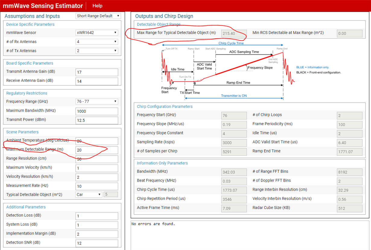

Question 1, so according as below picture that is example, Maximum Detectable Range is 20 m, but Max Range for Typical Detectable Object is 215.4 m, is it right?
Question 2, if we need to improve azimuth angle resolution, how should we do?
And how should we do to test the azimuth angle resolution?
Question is according the mmWave Sensing Estimator, could the Max Range for Typical Detectable Object be longer than Maximum Detectable Range?
If not, why the mmWave sensing estimating was not show error?
Maximum Detectable Range is user input and Sensing estimator would configure other parameters to meet this, if possible.
But if you change other parameters manually, You can increase "Max Range for Typical Detectable Object".
Looks like you are defining a very high range configuration as Antenna gains are quite high and Resolution parameters are very relaxed. Do you need help with any specific configuration.
