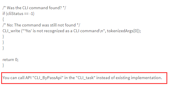

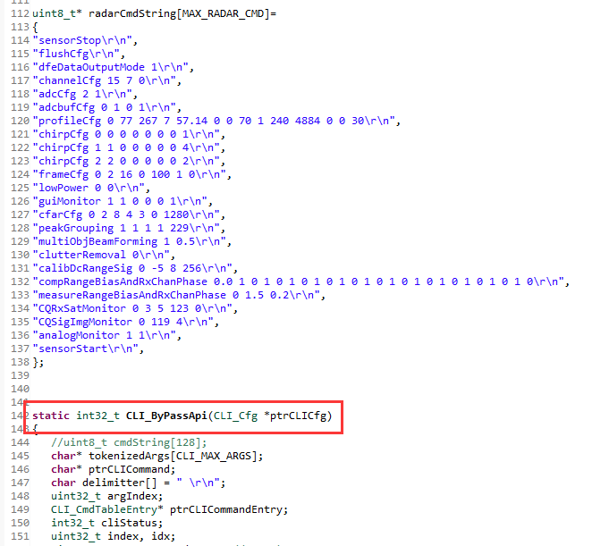

hi ,I want to know how to cal
static int32_t CLI_ByPassApi(CLI_Cfg *ptrCLICfg)  this funtion in my project,
this is for your answer,
 my bord is IWR1443BOOST ,so i change the parameter.
but I do not know where and how to call the funtion .

    Are you able to identify the CLI task?
    Please see notes in main.c:
    * -# Creates/launches following three tasks (the @ref CLI_task is launched indirectly by
    * calling @ref CLI_open).
    Thank you
    Cesar
