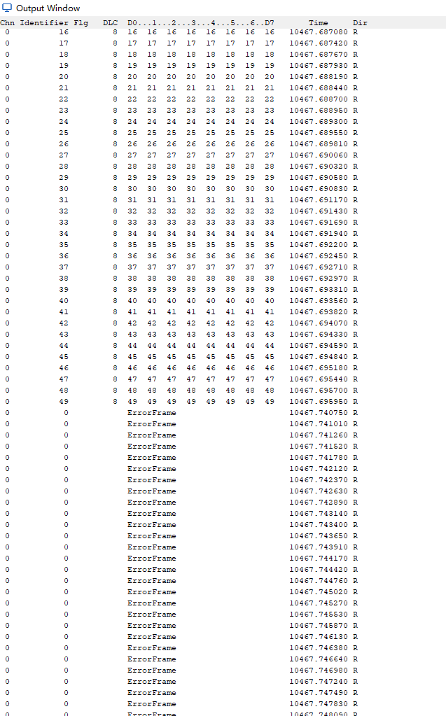

    I use the code to achieve the CAN sending message continuously with different message objects,But it doesn't receive messages very well during sending.
    I think it was affected by the local power loss!!! I cannot receive CAN signals from other devices while sending messages continuously!
    Is there a solution?
    Thank you

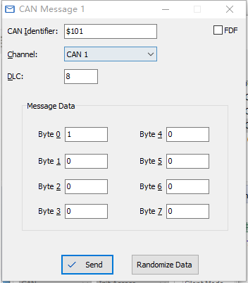

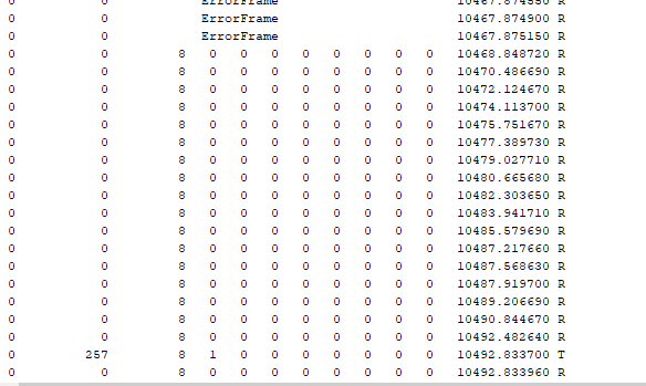

    It is not a matter of priorities!
    Iwant to continue send ID = 0,1,2,3,....,49 messages, I want to receive  message object id  = 0x101 in the process,but the following appeared:
    In the process,it will appear  the error frame, and many message object what ID = 0!
    That's not what I want.
    I just want the TX send continue message ID =0,1,2,....,49.
    At some point, I send a message id = 0x101, the output window is : ID = 0,1,2,3,0X101,4,....,49,0,1,2,3,4,5,....,49,...........

  • Hello Yaowei,
    I checked the DCAN driver code in the MMWAVE-SDK and have made some modification to transmit continuously from the device (msg Id: 0xc1-0xc9) and then also have receive message object (msg Id: 0xA1).
    Also was able to receive the data on the device side .
    Please check the attached
