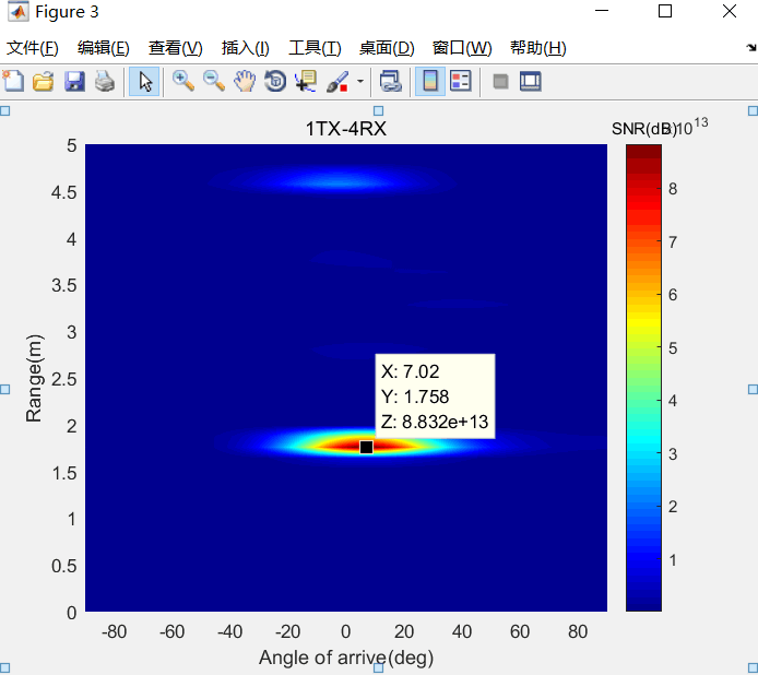

I am now trying to test the raw data about TDMA MIMO(2Tx, 4Rx) system using IWR1443
I use the fft method to measure the range and angle. For 4 Rx, each Tx (1Tx, 4Rx) can get the same angle result. In order to get better angle resolution, I put two <1Tx, 4Rx>data together to get 8 virtual antenna and the result has 6 degree deviation compare to (1Tx,4Rx)result. Do it means I need to add the calibration at the transmiters? How can I remove this difference

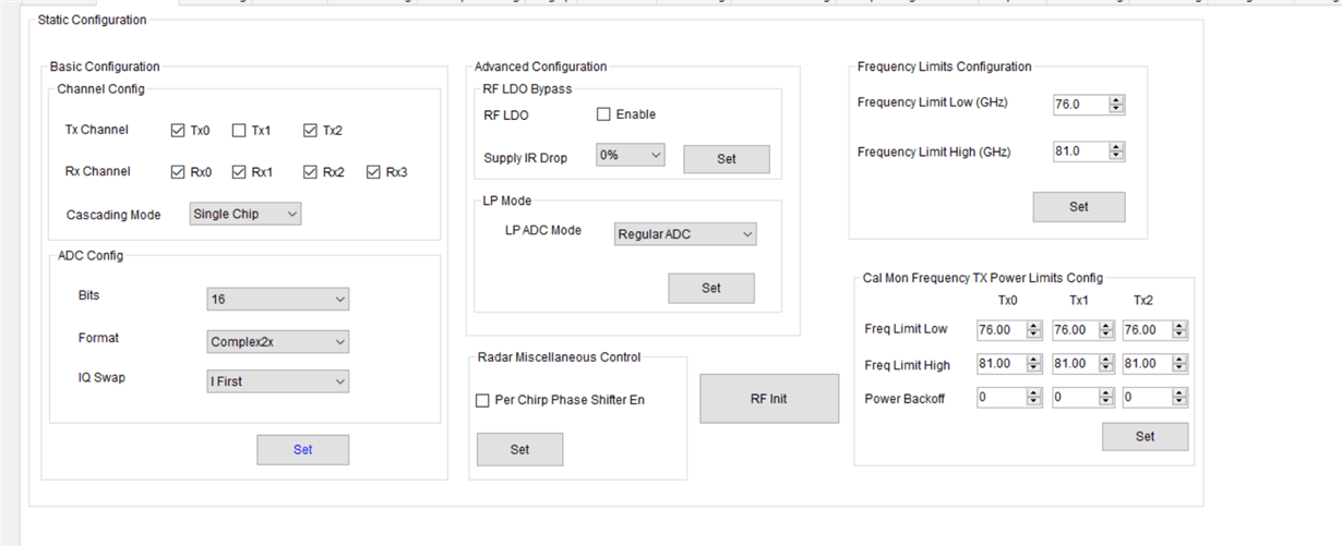

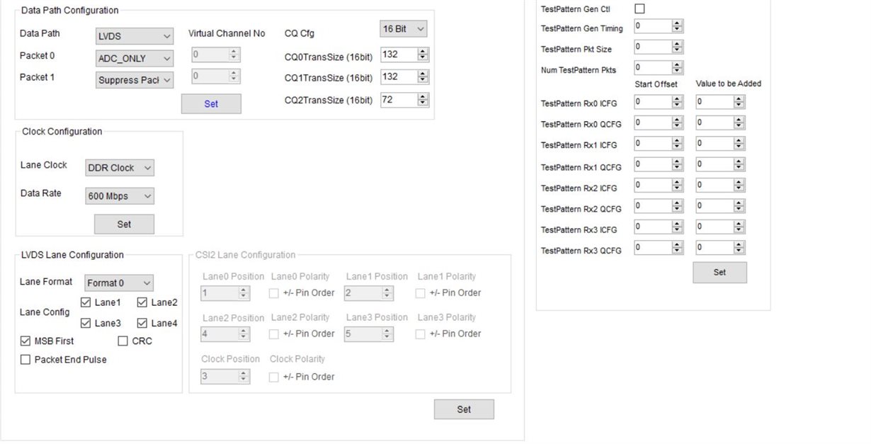

     Yeah, I used the Tx1 and Tx3.  Actually I have tested the 3Tx+4Rx, Tx1 and Tx3 combination also has 6 degree deviation compare to(1Tx,4Rx). I just set 'Connection, StaticConfig, DataConfig,SensorConfig' page, and others is default in RadarStudio. Do you know what may cause this difference?

    I don't think it may cause by the resolution problem, because I try to find the most value in fft(range and angle domin) result cluster which has the 6 degree difference in 1tx-4rx and 2tx-4rx. If the resolution is different, I think it may effect the cluster size, not the most value point.
    The attached file is the result for 2tx-4rx, and 1tx-4rx(one target scenario), can you help me to check it out?

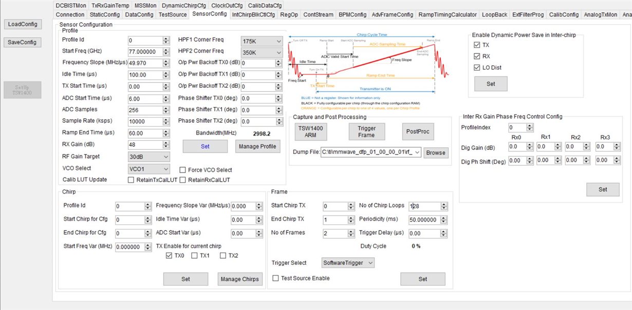

    One thing I'd like to check is how did you setup the tx1 and tx3 using the chirp index. What I suggest to do after chirp profile is set, in the chirp section, first choose Start chirp for config and End chirp for config both as 0 with TX0 selected, press "Set". Then change Start chirp for config and End chirp for config both to 1 with TX2 selected, press "Set" again. In frame config, Start chirp TX is 0 and End chirp TX is 1.

  • Hi Michelle,
    1) I use the fft-method and music method to process the data, and test the target from different angle, but the result always has about 6 degree difference between 1tx4rx and 2tx4rx for these two methods.
    2) I set the same profile for two tx, and set the chirp config as you say. I think it may have some other problems.

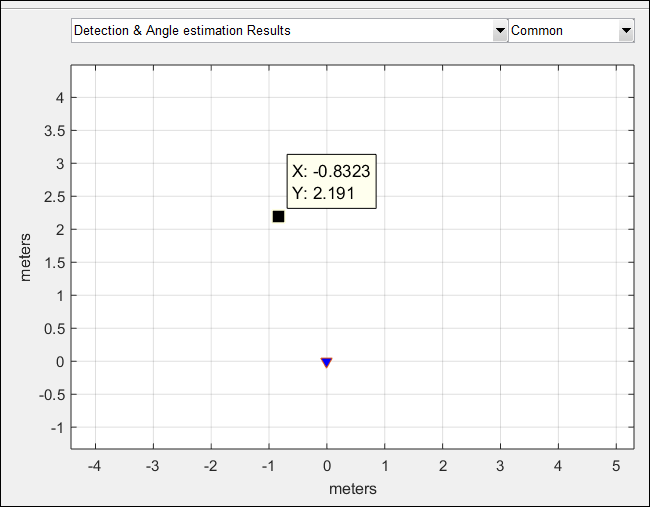

  • Hi WeiHua,
    To check the exact location of the object, you can use the matlab tool button and find the object location.  See attached figure for example. Then you will can tell if there's differences when using different TX selection.
    Thanks and Regards,
    Michelle

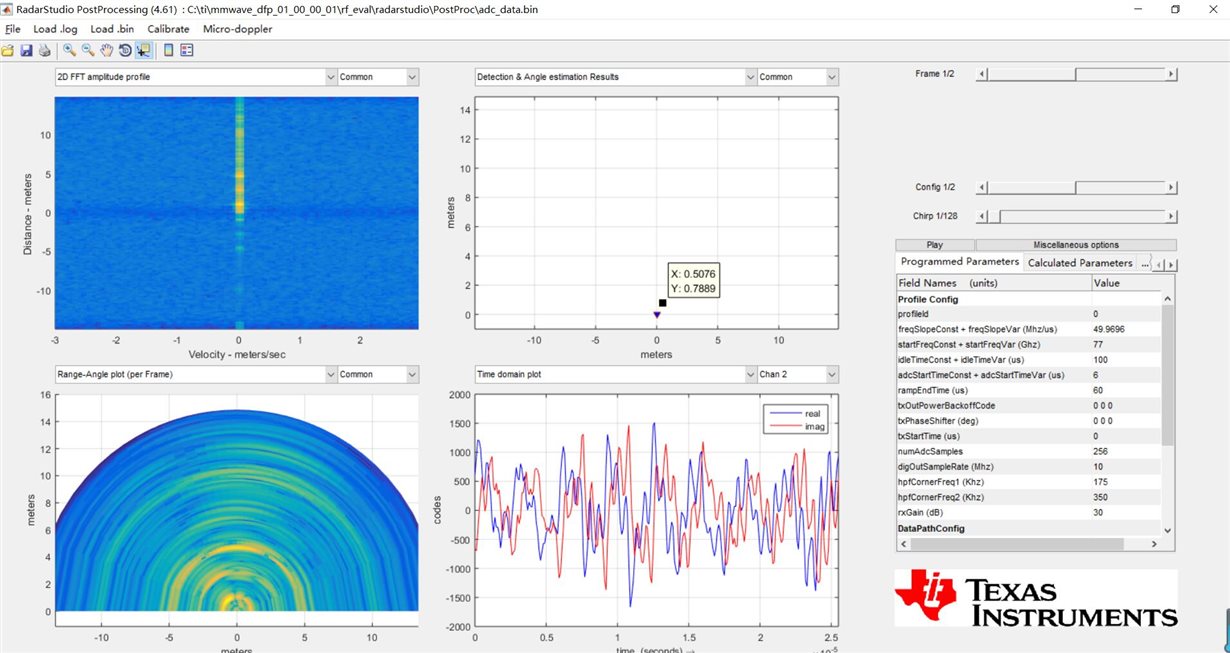

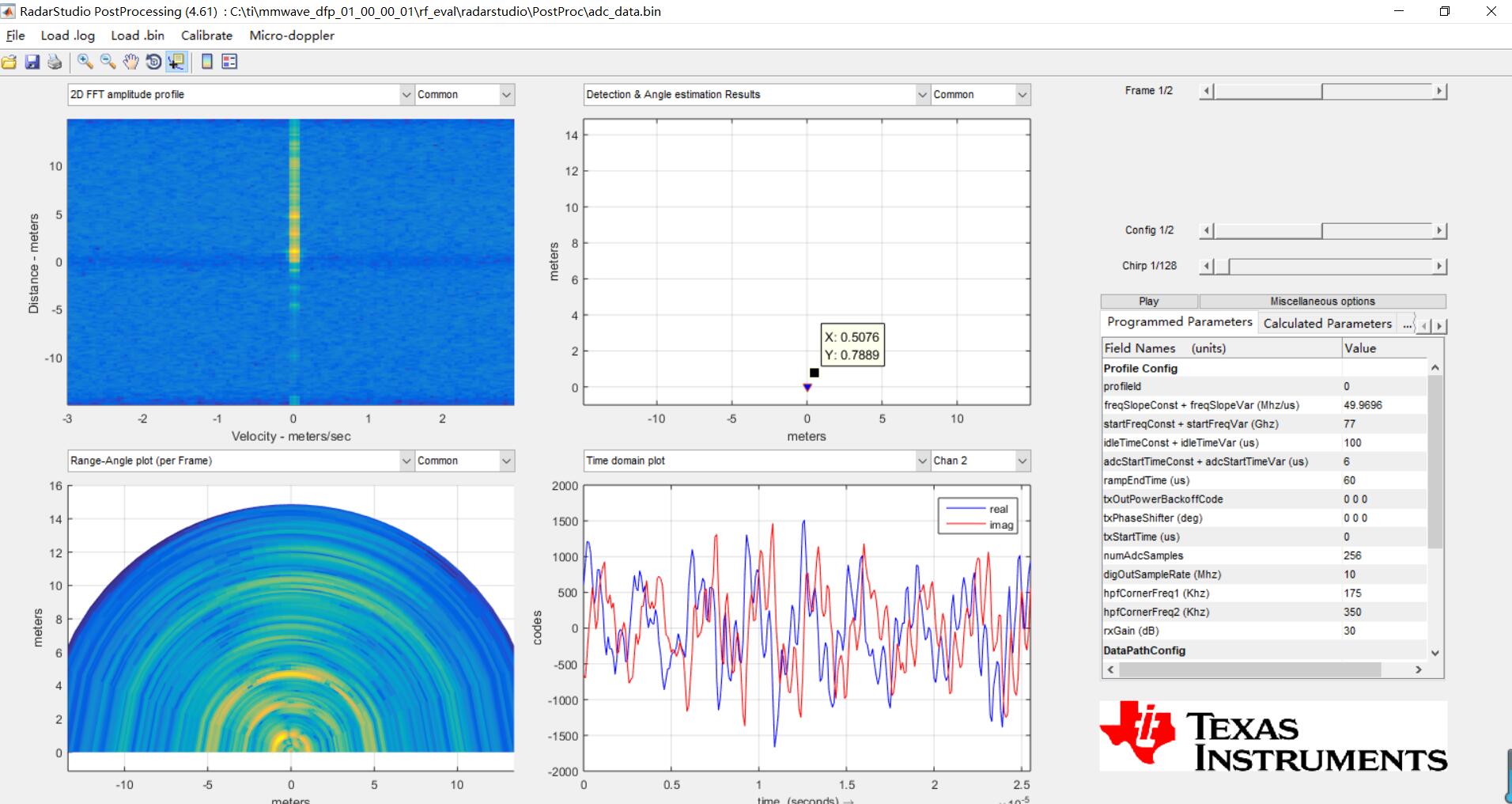

  • Hi Michelle,
    I know what you mean, and I have taken one more experiment. For tx1-rx4 and tx2-rx4, there are same angle results in radar studio 'Detection & Angle estimation Results' .
    But if I put these raw data in my fft process code,  for tx1-rx4, my result is same as radar studio. For tx2-rx4, it always has 6 degree offset between my code processing and radar studio post-processing----however, when i get the 2 tx signal from tx2-rx4 data and form 2 tx1-rx4 data, then test these two tx1-tx4 respectively, the results are also right. I am confused whether you have apply the calibration in post processing, and how you put these 2tx signal together---i firstly get the tx0-rx4, tx3-rx4 data, then put it as [tx0-rx4 tx3-rx4].

  • Weihua,
    Sorry for the delay. It took us longer than expected to find out how mmwave studio post-processes the data. The detection by mmwave studio is per tx only. It's not a combined nor a calibrated result. So your post processing may have no issue and mmwave studio should not be used as a comparison. We suggest you could use mmw demo to check if it is consistent with your calculation.
