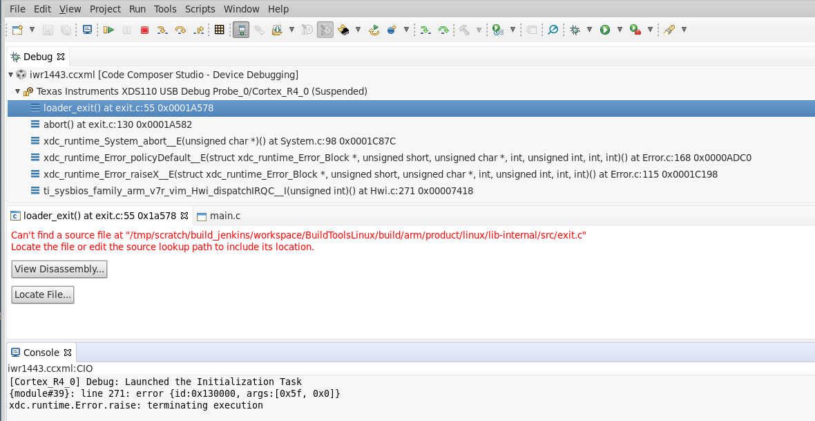

I built the oob demo for a iwr1443 board using CCS 7.4 on a linux platform.  The SDK version was 1.2.0.5.  I loaded the binary in the part using uniflash  version 4.4.  It did not run so I attempted a debug session with CCS.  I had no build errors or warnings during the build process.  I can load other prebuilt binaries and they run fine.  I have attached a screen image of the debug session.  It can not find a file from a /tmp/scratch/build_jenkins/.... location I do not have.  I searched for assistance on the forum pertaining to the missing file and found this posting: CCS/TMS320C6748: ccsv5.5 - can't open time.h and rand.h.  This old posting does not provide any assistance to me.
Please advise.  Thanks.

    Let me first address the "Can't find a source file..." message shown in the debugger. This is a general debugger message which indicates that the debugger is unable to map the instructions being executed to a source file in order to show the source view. The code is halting/crashing in TI RTOS and then calling C library functions (abort and exit) and these components were compiled on another machine (more specifically, different build paths) which is why the debugger is unable to find the source files. Please refer to the following post for more information.
    https://e2e.ti.com/support/development_tools/code_composer_studio/f/81/t/389267?CCSv6-debug-cannot-locate-source-file
    In order to look into the reason for the crash, please provide the following information:
    1. Environment setup file setenv.sh used in your build (as mentioned in section 4.5.2.2)
    2. Complete build log from the terminal, including the sequence of commands you executed.
    -Nitin

    Thank you for responding.  I ran the debugger since when I loaded the generated bin file to the part, the gui did not function at all like it should have from based upon the prebuilt binaries.  I also connected minicom to the port and I was not getting readable characters back (like mmw> and Done) when a command was issued.
    I can not seem to attach an ascii file so I will inline the material you have requested.

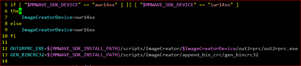

    Yes, am aware of the permissions issue. What I sent you was output based upon the installation instructions. I assume when the windows binary failed to run, no crc was created and appended by the gen_bincrc32 binary or is just the genbincrc32 the only binary required in the linux version which creates the crc and appends it?
    I had then changed the permissions on out2rpcr.exe so mono could execute the binary. I received no error on the build but the binary did not work on the part.
    I did comment out the window's part in generateBin.sh but still got the build error which is bothersome. I assume that since the shell script errored out when it could not run out2rprc.exe, the script stopped running and did not run gen_bincrc32.
    So, I'm I too edit the generateBin.sh to remove the window's binary run? If so, the file I edited has not effect on the build process. I had then search the file system to see if another generateBin.sh existed. Another one existed inteh xwr16xx space but I am should not be in that space.
    Please advise.

  • Allen,
    You should not need to change anything in generateBin.sh provided as part of SDK installation.
    After the compilation (and linking) step which produces a .xer4f file, the flash-able binary is generated in 2 steps,
    Step-1
    Out2rprc.exe is executed using mono (which executes windows executable on Linux) to generate .bin image from the .xer4f. The following code from generateBin.sh does this.
    # To convert .out to .bin file
    # mono runs windows executable on linux
    echo mono ${OUT2RPRC_EXE} "$@"
    Step-2
    CRC is appended to the bin file using gen_bincrc32. Note that gen_bincrc32 (without any extension) itself is the Linux equivalent of gen_bincrc32.exe which is present in the same directory. On Linux, the generateBin.sh script calls the Linux equivalent as per the following code:
    GEN_BINCRC32=${MMWAVE_SDK_INSTALL_PATH}/scripts/ImageCreator/append_bin_crc/gen_bincrc32
        # To append CRC of image in the same bin output file.
        ${GEN_BINCRC32} $2
    1. "I had then changed the permissions on out2rpcr.exe so mono could execute the binary. I received no error on the build but the binary did not work on the part."
    [NS]: This is OK. If out2rprc.exe and/or mono did not have execute permissions for some reason, you rightly changed the permissions to be able to execute it. out2rprc.ece is executed through mono to generate the .bin from .xer4f
    2. "I did comment out the window's part in generateBin.sh but still got the build error which is bothersome. I assume that since the shell script errored out when it could not run out2rprc.exe, the script stopped running and did not run gen_bincrc32"
    [NS]: I'm not sure what "windows part" means here. As detailed in the above steps, the CRC is appended using gen_bincrc32 (no extension) utility which is called inside generateBin.sh.
    You do not need to change anything in the script. However, you should check the permissions on gen_bincrc32 (no extension) utility as well and enable execute permissions on it using chmod if needed.
    3. "So, I'm I too edit the generateBin.sh to remove the window's binary run"
    [NS]: Again, if you have all the tools installed correctly and both out2rprc.exe (including mono) and gen_bincrc32 have execute permissions, the build should work without having to change anything in generateBin.sh

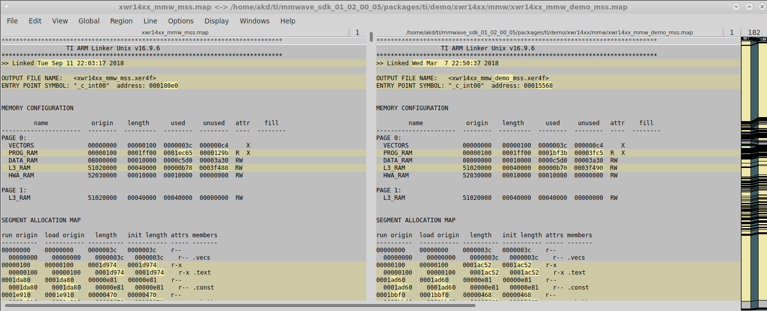

  • Hi Nitin,
    Thanks for the clarification.  I will try one more time with the permission's bit set to execute and not changes to any scripts which will result in no gmake build errors but I am afraid it will not run correctly since I have tried that.  When I monitor the config serial line, I get none ascii characters coming from the demo board.  With a prebuilt binary, I do not.
    Would decompiling the binary I build and the prebuilt provide additional information?  I am between a rock and a hard place.
    I am out of the office for the day.  What else can you suggest that I look at?
    Al
  • Nitin,
    I regenerated the binary.  No build error were reported.  The  reported crc was >>>> Binary CRC32 = 59b2ba9f <<<<.  I checked the end of the generated binary with a hex editor.  It did have the current crc.
    I do not have the hardware with me to confirm if the binary will run on the part but I suspect it will not since I have tried but I will try  tomorrow.

  • Allen,
    If this doesn't work, you can begin by comparing the file sizes and corresponding .map files for the pre-compiled binary and your own version to see if there are any significant differences.
    Also, just to confirm, when you flash your own compiled binary please ensure that you also flash the RADARSS firmware in MetaImage 1 as mentioned in this thread:

  • Nitin,
    I have always flashed the radarss firmware image everytime I flashed a new MetaImage 2 binary.  The file sizes are
    prebuilt:  117580 bytes xwr14xx_mmw_demo_mss.bin
    my build: 129148 bytes xwr14xx_mmw_mss.bin
    The .map files are significantly different in content.  I have
    prebuilt: 361038 xwr14xx_mmw_demo_mss.map
    my build: 363023 xwr14xx_mmw_mss.map
    The attached image illustrates that the difference amount between the two map files is significant.  The yellow/black bar on the right highlights the differences.  The yellow indicates differences and the black indicates no difference.  I have also attached my .map file.  The prebuilt version I assume you have (perhaps too large to include both).
    I do not have the experience to compare and contrast the two .map files to ascertain what is wrong.
    I will re-confirm in the morning that my build will not run in the part.
    Al
