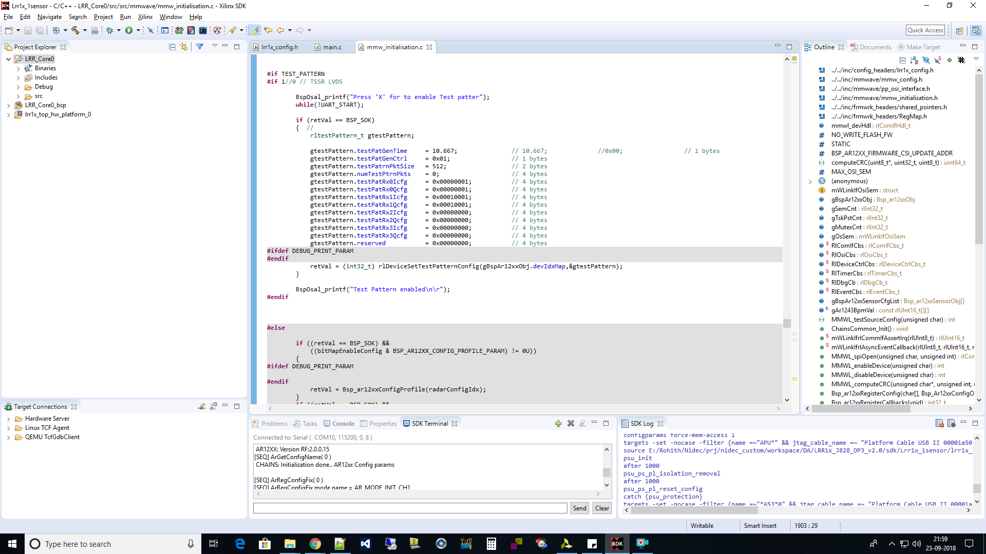

I'm Validating my LVDS Logic Implemented in Xilinx FPGA
LVDS Data rate = 900 Mbps & My test pattern related setting in mmWave SDK are attached in the below screenshot

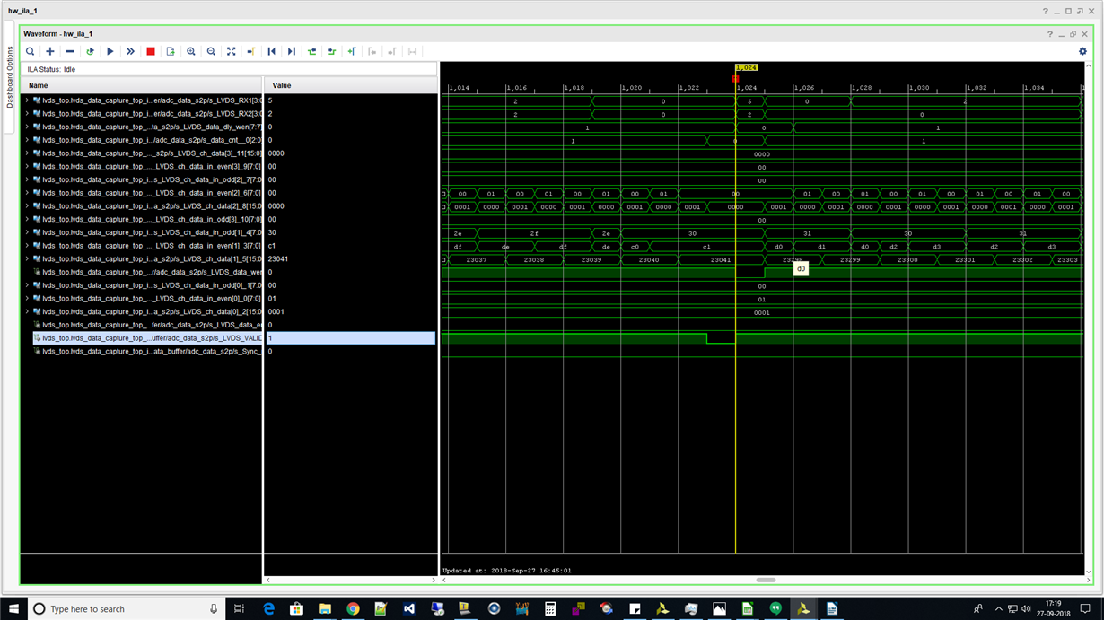

In my Chipscope capture of LVDS data (after serial to parallel conversion), seeing a jump the counter data. at the same time, I'm seeing "LVDS_Valid" signal going low.
The Jump of the counter is dependent on test pattern packet size (tested for 512 or 256)
This can be observed in figure "LVDS_Vivado_Capture1.png" and LVDS_Vivado_Capture_Analysis.xlsx" (data captured multiple times)

  • Hello ,
    The DATA VALID would be high during the period the chirp data is being sent out and will go low until the next chirp data starts. The test pattern is also emulated as 'chirps' , just that the data is fixed rather than actual ADC measurements. So yes, data valid will go low.

    Out problem/issue is, there is a large deviation in the difference between the last sample of current packet and the fist sample of next packet. Our observation are:
    1) This deviation happens at the start of every packet, all the time.
    2) The difference is usually 511, 512 or 513, when the packet size is 512. The difference is around 255 when the packet size is 256.
    3) We have estimated that this change happens at start of every new packet by looking at Data_VALID going low.
    4)Within a packet, the samples increment by 1, as expected.
    5) Across packet also we expect the samples to be incremented by 1 only (not happening). We are not sure, whether this expectation is correct.
    Any help on this part would be highly appreciated.

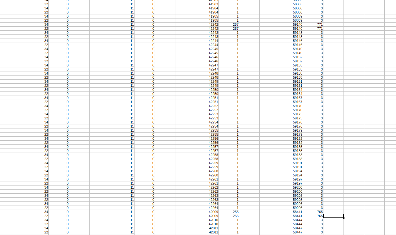

  • Hi
    Please find the image where we show the real and image data captured in excel sheet.
    Packet size (256), real and Imaginary values are the same.
    As you can see, there is a jump of 257 / 771 on packet start and exactly after 24 samples (depends on packet size), there is jump down/decrease in value of exactly 255 /  765.
    This makes the value match and gets back us to the values as expected from test Pattern.
    My question is,
    Is this expected??? Can anyone help us on why this is happening???
    Please note that the first two channels have constant Test Pattern and there is no jump with this case

  • Hello Shanthana,
    Thanks for the confirmation, so does that mean with lower speeds you are no seeing any jumps now between the samples?
    This interface is only intended for basic checks on the data interface , not intended to be run at the full sampling rate.
    The start packet could be arbitory in the ramp based on where the internal counter was last and the roll back after 65535 is expected since its 16bit width.
    Vivek
