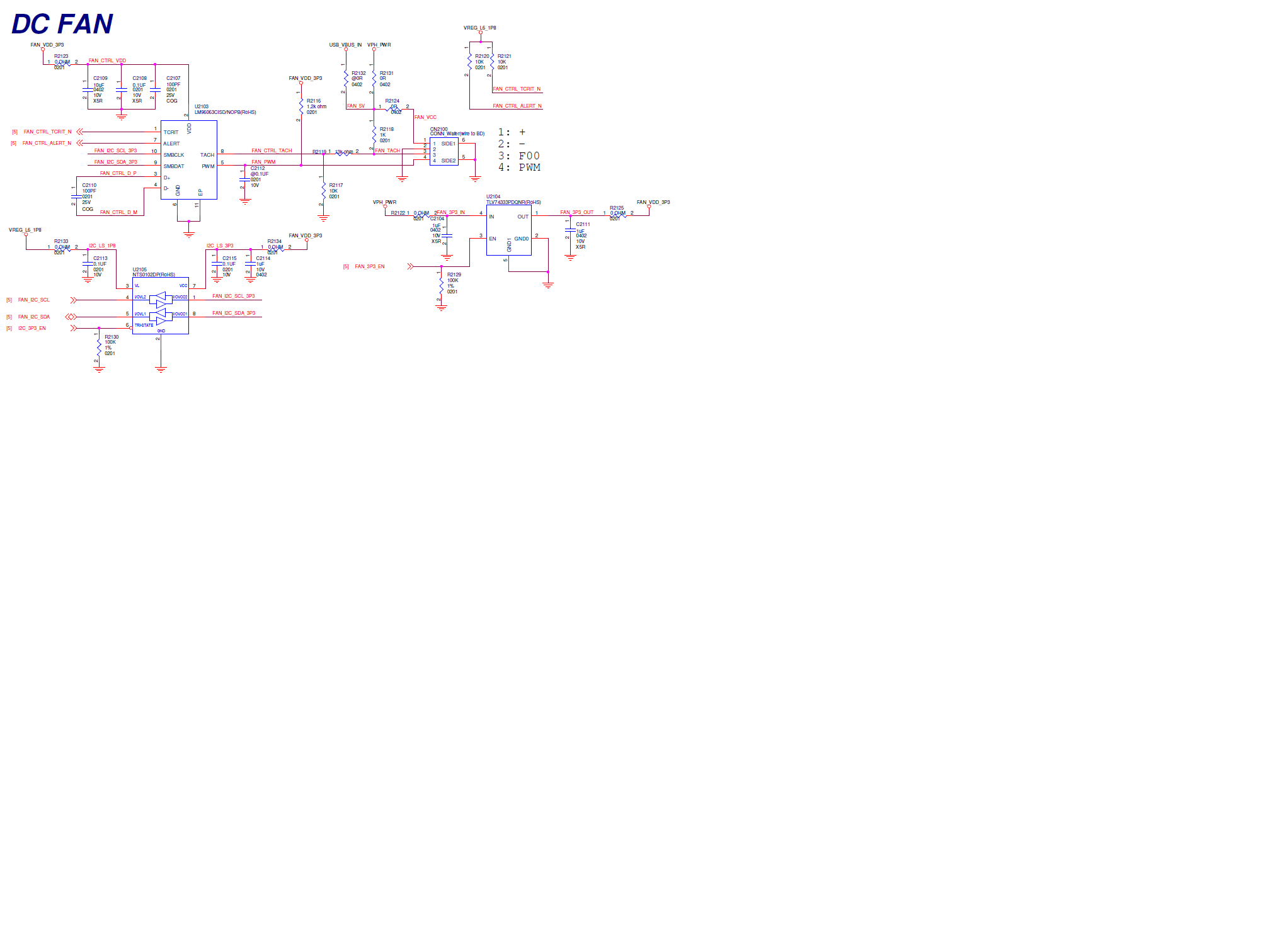

  • Hi Amit,
         Attach our current FAN controller circuit schematic for your reference. Thanks.
     regards,
    Sean
  • Hello Sean,
    Thank you for sharing the schematic. I do not see any pull up on the I2C line from the level shifter and the LM96063 on the signal lines FAN_I2C_SCL_3P3 and FAN_I2C_SDA_3P3. Can you please confirm if there are pull up resistors and when in Idle state of the system, the SCL and SDA are indeed "Logic High"?
    If possible can you please send a snapshot of the I2C bus transaction to make sure that the address and data written by the controller to the LM96063 is being ACK'ed?

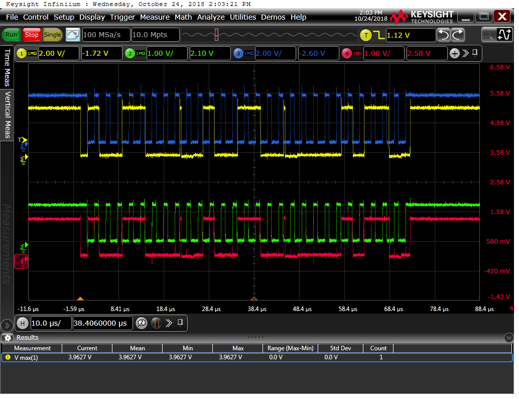

  • Hi Amit,
    The dumped values of registers that post in previous reply are read from i2c transaction. You can check the register 0xFF for the chip id 0x49. Will re-measure the i2c bus transaction and send you the wave form for the reference,before this,do you have any suggestion on the register configuration without remote diode design?
    regards,
    Sean
  • Hi Amit,
         Check with hardware team the FAN_I2C_SCL_3P3 and FAN_I2C_SDA_3P3 are Logical high in idle state and does not pull high in current schematic. Attached the wave form that access the reg 0x4c for writing 0x0b.
