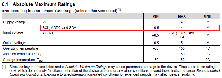

Hi Team,
Is it possible to apply 3.3V to SCL, SDA and ADD0 when powering off (V+=0V) for TMP112?

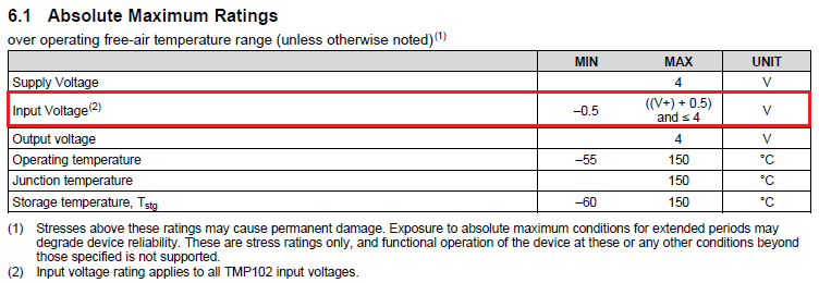

It seems no ploblem according to datasheet however TMP102 shouldn't to apply above although these devices are pin-to-pin compatible..
Could you check it just in case?
↓TMP112
↓TMP102
