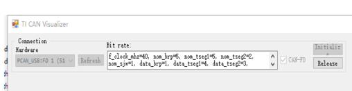

1. I just use Object data over CAN (TI REX project), and the corresponding TI CAN Visializer application.But once the TI CAN Visializer initializes, the waveform disappears.

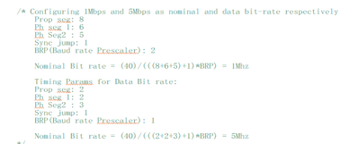

2. As shown below, I don't understand why the values written in these two places are different? How should I convert these two values?
