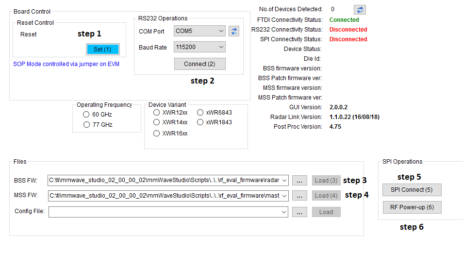

I have issues with configuring the board to connected through Ethernet. I followed the necessary steps.
Configured IP to static. 192.168.33.30
SOP0,SOP1
DCA1000 switches configured
SW1:
16BIT_ON and the other two are off
SW2
6.7.8 --> SW1,2,3
5: SW_CONFI
4: RAW_DATA
3: 1243_MODe
2: ETH
1:LVDS

    Your setting on SW2 should be like the table below.
    position name
    SW2.8 OFF USER_SW1
    SW2.7 OFF USER_SW2
    SW2.6 OFF USER_SW3
    SW2.5 ON CONFIG_VIA_SW
    SW2.4 OFF RAW_MODE
    SW2.3 ON AR1642_MODE
    SW2.2 ON ETH_STREAM
    SW2.1 OFF LVDS_CAPTURE
    On the ethernet disconected issue, you need to make sure that your PC says that its connected, see image below.
    another check is ping the address 192.168.33.180 from the command promt type: ping 192.168.33.180, you will get a timeouts because the DCA1000 will not respond and you will see that all data packets are lost, but you should see the LED on the DCA blink.
    Also use wireshark to see communication from the PC to DCA.
    hope this helps
    Alex
  • Hi Alex,
    thank you that kind of resolved the problem as I am able to connect to the FPGA now but I still get the error when testings the DataCaptureDemo.
    The DatacaptureDemo, only worked when I just started up the mmWaveStudio, and After I redo the steps to attempt to connect to FPGa after testing DatacaptureDemo, FPGA won't connect. Going back to the ethernet problem again.
    It is more like I cannot do both one after another through mmWave?
  • hi,
    redo the steps? you only need to set up the DCA1000 once, after that you can:
    1) DCA1000 ARM
    2) Trigger Frame
    3) PostProc
    several times, no need to re-set up the DCA1000.
    I would recommend you do all steps manually and see if you get any errors that way.

  • Hi Alex,
    What I really would like to know is this,
    Do I have to configure the DCA1000, everytime I power it up? and do I always need to establish all the 6 connection steps to issue a software trigger?
    1- Reset 2-COM connection 3- BSS download 4-MSS download 5- SPI connection 6- RF power up ?
    And, What is the difference between SW2.6 set to EEPROM or hardcoded FPGA? and which one ensures that configurations are saved without having to reconfigure after a power cycle?
  • Do I have to configure the DCA1000, everytime I power it up?
    Yes
    Do I always need to establish all the 6 connection steps to issue a software trigger?
    No, you can just do DCA1000 ARM and Trigger Frame, optionally PostProc
    If you decide to not do the PostProc then you need to do the packet reorder manually.
    With the FPGA you cannot change the settings, on the EEPROM you can change the default values and keep them after powercycle.
    Hope this was helpful
    Alex
  • What I mean by the 6 connection steps is this:
    And Configuration is -->
    I think if I do not establish a connection in mmWAVE studio, I won't be able to configure the board? However, I attempted to configure and resulted in error!
    I am confused now.
    Further, why there is not a way to hard-code specific configurations and only change them when I decide to?
    I did not quite understand the difference between FPGa and EEPROM?   what is hardcoded on FPGA?
    I thought I can store the configuration on either and when I use the board again, I'd be just ready to trigger data-capture!
    There is currently no way of setting up the device without mmWave studio.
    The firmware that gets loaded with mmWave studio cannot be hard-coded, unless you create your own binary file similar to the Labs or demos in the industrial toolbox.
    the FPGA you cannot modify the settings (IP addresses, ports),  on the EEPROM you can edit said settings
    you can create your own binary file similar to the Labs/demos in the industrial toolbox.
    Alex
