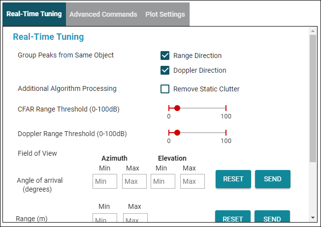

I want to use TI Demo Visualizer to visualize the 3D point output from IWR6843. But I got a very sparse point cloud. I want to know how to adjust the parameters to show a denser point cloud. It would be better to depict the general shape of the detected object.

    You can increase or decrease the number of detected points using the the Real time tuning tab on the mmWaveDemoVisualizer as shown below:
    1. Peak Grouping for both Range and Doppler is enabled by default. With the peak-grouping scheme enabled, instead of reporting a cluster of detected neighboring points, only one point, the highest one, is reported. This reduces the total number of detected points per frame. You can disable peak grouping and see the number of points increase on the scatter plots.
    2. CFAR threashold (Range / Doppler): These are the thresholds used in the demo processing chain to consider a peak as a valid detected point. Increasing the threshold reduced the number of detected points and decreasing the thresholds increases the number of detected points.
    3. Field of View: You can set the Field of View parameters: min and max range, min and max angles in azimuth and elevation to define your zone of interest per the application requirements. This will avoid allocating detected points beyond the desired FOV and thus increase the number of detected points in the specified region.
    Please refer to the mmWaveDemoVisualizer user guide for more details.
